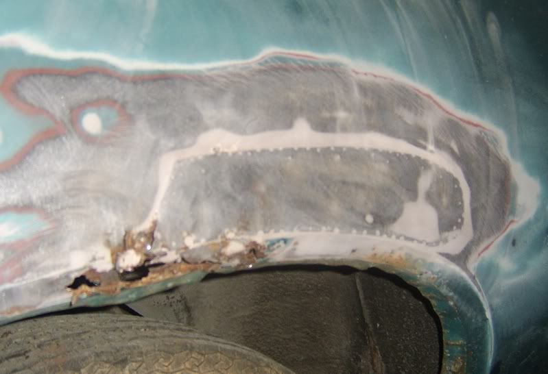

I will be putting outer wheelhouses and quarter skins on my 68 GTO 'vert.
I have spent many an hour researching this and other websites and have decided I will butt weld the panels together. I ordered some cleco pliers and fasteners to hold everything together and just bought a lincoln 180. My garage is also equipped with an 80 gallon 4.5 running hp compressor. I will buy some sheetmetal for practice before I have at it.
Here is what I'm dealing with:
http://i102.photobucket.com/albums/m93/clarkbar04/GTO/righttopquarter.jpg
cut the amateur patch job out with my cutoff tool
http://i102.photobucket.com/albums/m93/clarkbar04/GTO/patch.jpg
Are You going to do full skin's or partial's? I gotta tell Ya, it's alot easier for the rookie to hide the seam's at the factory locations.
I should add that You already have the tool's, I believe that You can do it. I had some experience, not that it mattered that much, all the knowledge is right here at Your finger tip's.

The goat world is not as blessed as the chevelle world when it comes to repro stuff. There are no full quarters for a 68 convertible. I will splice it in probably 3" down from the top of the panel.

I thought that You posted a link to GTO panel's. I'd have to look into maybe sliding the wheelhouse's under the 1/4's, and just patching as little as possible on the lip of the panel.
