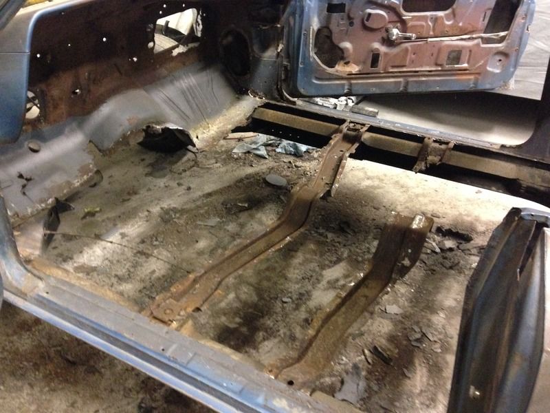

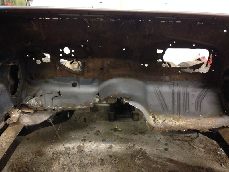

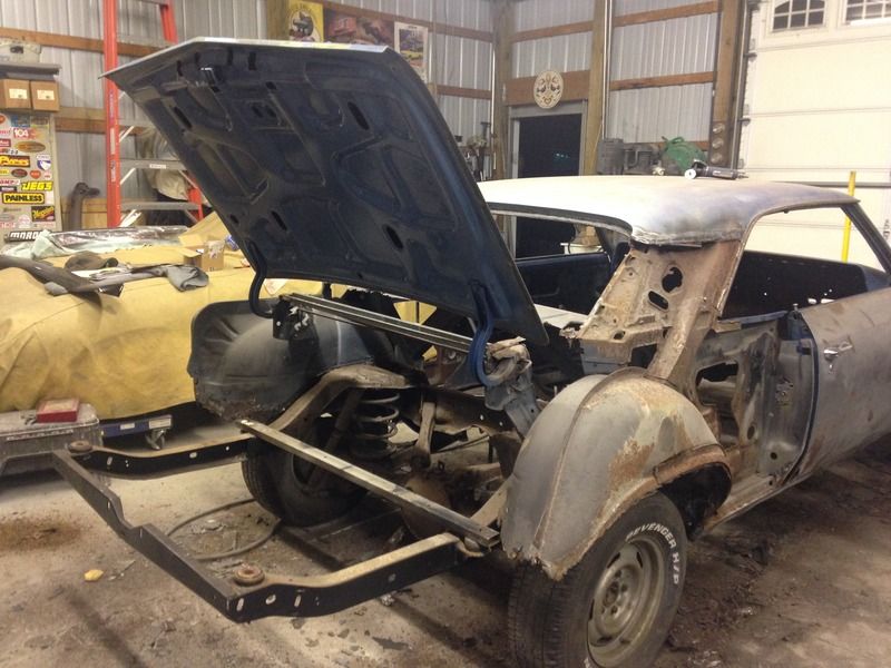

Cut it apart!! Wheel tubs, 2 floor braces, and firewall still have to come out.

Holy Moly. My 66 has a little rust by the rear window and I almost thought it wasn't worth keeping. Gotta give you guys that tackle these big jobs kudos. Cars like that around here are usually crushed. Jim

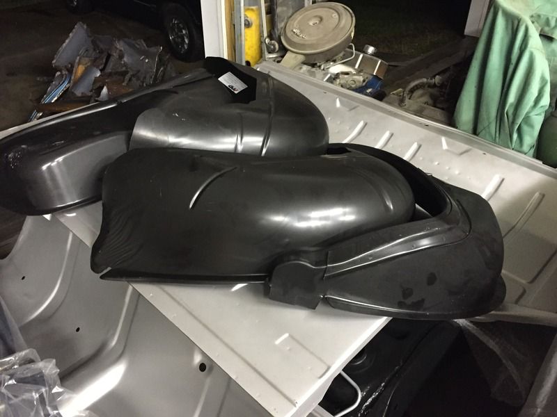

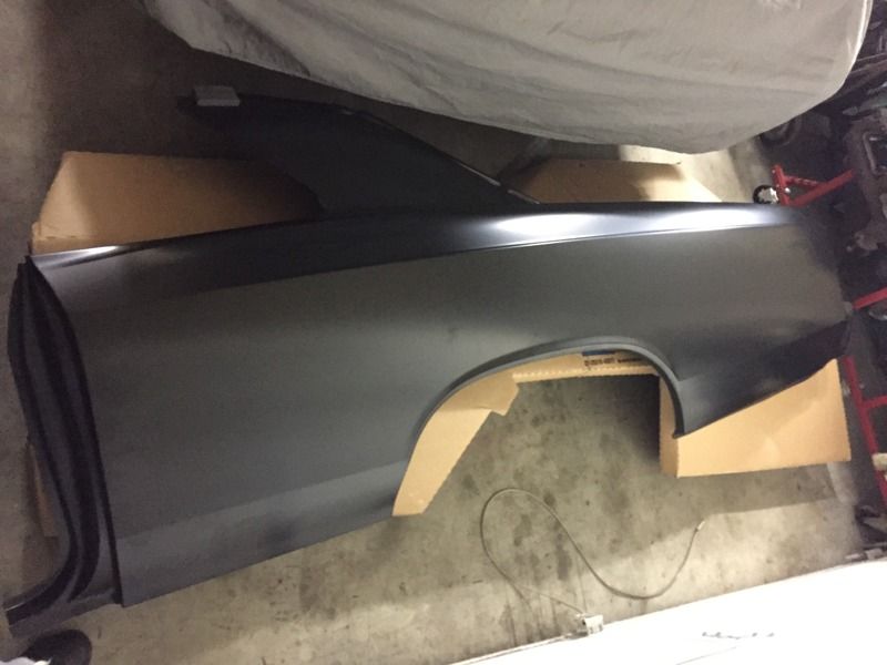

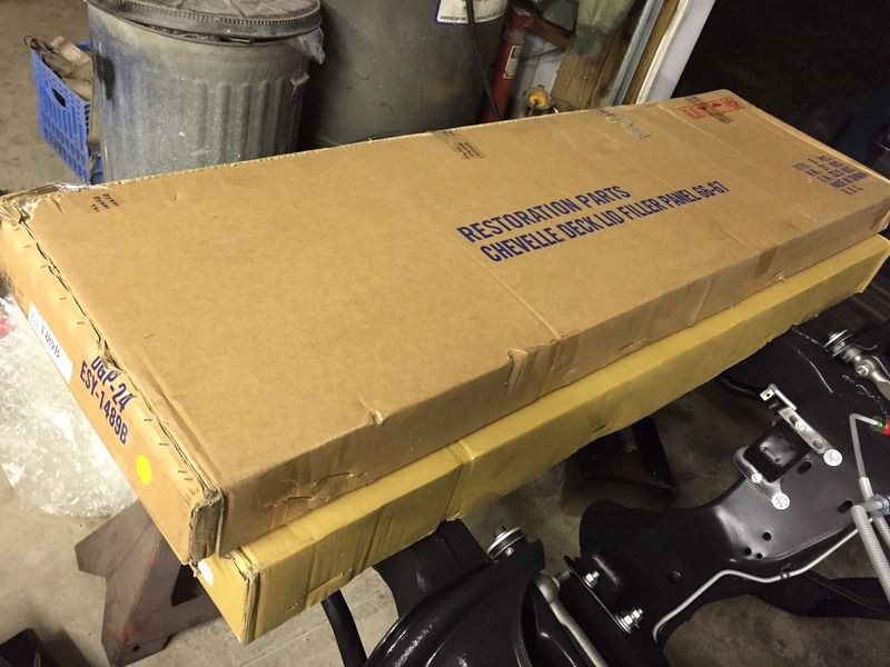

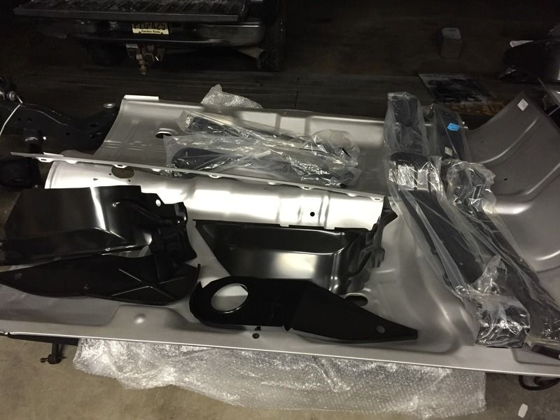

I am using a mix of AMD and Dynacorn. I get metal locally from a friend of mine that is a distributor for both so I can just go pick it up when it comes in. I am replacing the firewall, cowl front and sides, floor pan, front and center braces, trunk floor and drop offs, quarters, deck filler, speaker tray, inner & outer wheel houses, fenders, and radiator support. I am going to try and save the door skins and right outer rocker if I can. The lower cowl is good. The bottom of the A pillar/kick panel area is gone so I have to fabricate that. The hood, roof, and deck lid are still good.

Mixing those panels is not a big deal, but could be a pain in the butt.
I hope you took a lot of measurements before taking those panels off.
You are going to have to adjust all those panels to fit what you have already on the car. Always does.
