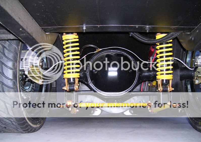

BillyGman - thanks for the pic and the link. More photos of my 68 are in the link in my sig.
engineguy - thanks for the info about the backflow/power loss aspect. Good to know I can maybe just run a pair of bullets under the trunk/ fuel cell if the Flowmaster replacements and tailpipes alone don't quieten it down enough. Good call regarding the heat shield too - a heated fuel cell is not an option!

GM used to put "resonators" (2nd mufflers) on alot of their large luxury models in the late 60's, early 70's. Most looked similar to a glasspack and were located outside the rear framerail, behind the quarter panel dropoff. On a stock or mildly modified Chevelle rearend there is plenty of room.
BUT, your 4 link suspension may cause a bit of a routing issue.

I have been struggling to figure out how to get an X pipe in with my Gear Vendors there....your picture was great and I think I will go the route of the H pipe as well....

Also, where the heck is your transmission cross member?

If you are asking about my tranny crossmember, I don't run one I let the tranny sit on the H-pipe to save weight, lol. Kidding of course. The crossmember is round tube and you can just see the end of it if you follow the H-pipe over to the frame (it's grey).
