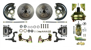

So, what did you 66 SS guy and gals use for your disk conversion. Don’t need to break the bank with Wilwood. Looking for a kit to replace front drums but also noticed if you get the 4 wheel disk it saves money in the long run. Trying to get something that will bolt on with not too much trouble as I’m doing this in my garage. If anyone has done this and is happy with the outcome I’d like to know. Any part or kit numbers would be very helpful. Photos are nice, lol
Thanks in advance. Oh my bad. Car is all matching numbers so I just want her to stop, not going to change much because of this. I have 15" rims on her now.
