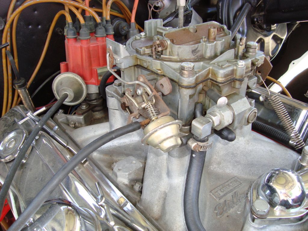

Here are pictures of the carb and where dist is hooked up,
http://i208.photobucket.com/albums/bb202/chevelle19721/DSC06773.jpg
http://i208.photobucket.com/albums/bb202/chevelle19721/DSC06774.jpg
Another problem I am having is starting the car hot, when it is cold i give it one pump and it turns right over, but when warm if i give it one pump it will start for a second then take a while to turn over. similar symptoms as if it was flooded. i am not sure if the hot start issue is a timing issue or if it is because i do not have the choke coil spring? Any help is appreciated, if you need any more details I left out feel free to ask.
