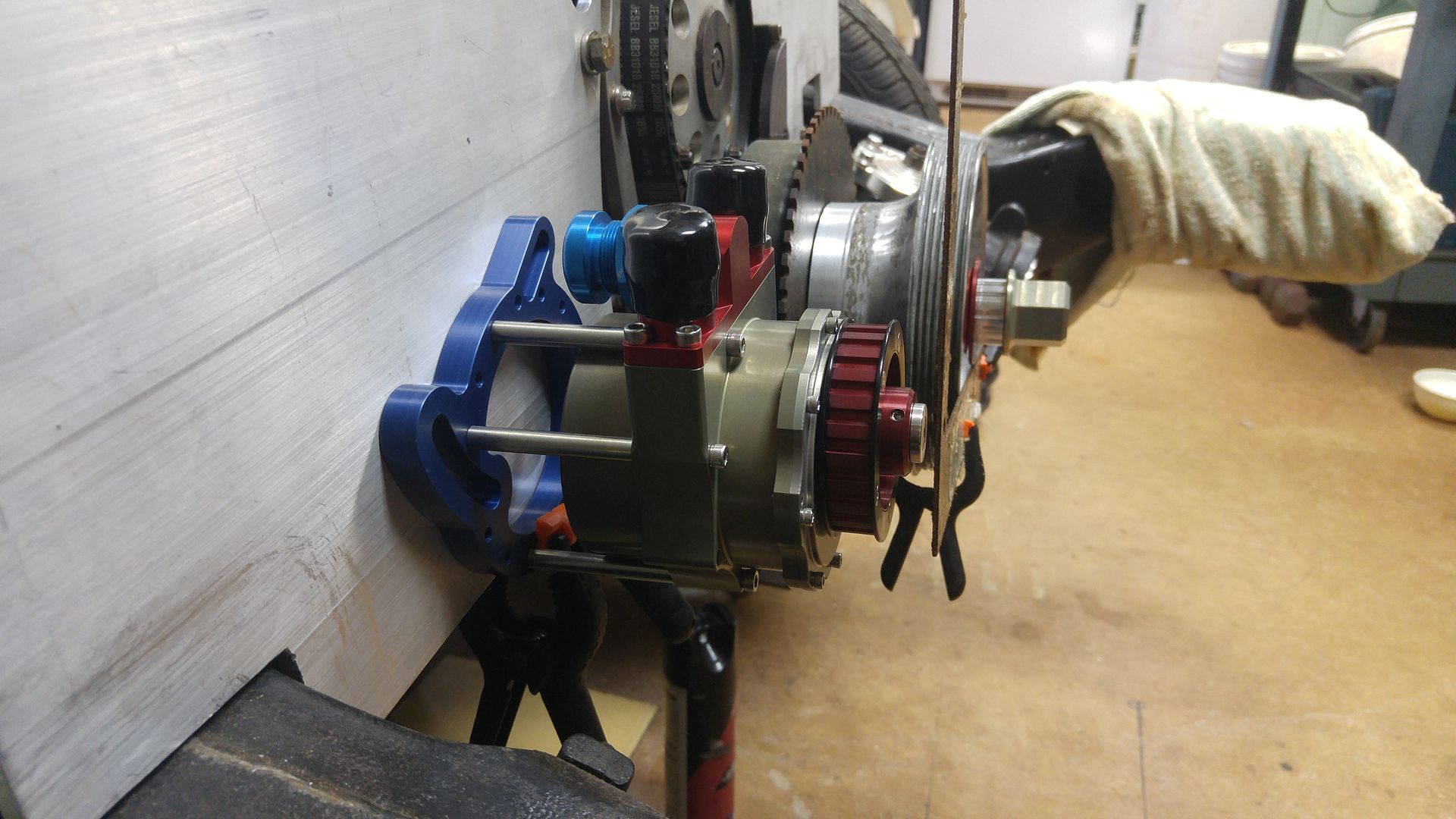

I'm going to mount a vacuum pump, and I needed 1/4" more space for the belt drive. So I am attempting to put in a front motor plate.I'm glad I had enough cardboard for templates. One side bolted right on, the other was a challenge to fit. As of now I will rest the plate on the frame, and put the bracket/tab behind. Later if it is a wear item I will plate the frame. Any other suggestions welcome. Here is my grass shack machinist blueing(Sharpie) also. I still have to tend to contouring, and fitting the vacuum pump, but it fits the frame.

Chris the motor plate is .250 thick, and I'm going to add a 3/16 tab/bracket welded to the frame, 2 bolts each side. I may add a mid plate at a later date, for now I'll still have solid side mounts.
If you wanted the actual weight it's 7.7 lbs as is.

I talked to Steve at Star, and found out the pump gear can be flipped around which helped a bunch. The pump needs to come out only .820 now to line up. I have a Vintage air front runner system to put on to set where the pump will go. Now I have to find the mounting frame that I haven't seen in 4 years. I did find all of the bolts, spacers, small brackets, etc.

The plate is my idea for getting the 1/4" spacing needed for the belt drive, and also to mount the vacuum pump. The Vintage air system takes up, or blocks all of the front mounting holes. The plate will hopefully also take some stress off of the side mounts. The headers are already made so no benefit there. In the future I may add the mid plate,

Well I welded in the frame tabs for the front plate. Now I have to use my nonexistent machining skills to to get my AC lines to clear the plate to assemble the front runner system.
