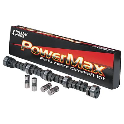

#3 ·
This should do what you want
Or

My two recomenations above are on the low side 350 hp/400 tq works with oem stall.
If you want more hp
375 hp
400 hp
But they need torque converter with stall and wont be as smoth as the two above. If its a cruiser no need to ”over cam” it imho.

#12 ·
Should work fine but personally I wouldnt run stamped steel rockers with that cam. I would contact trickflow and ask about more info about the springs on your heads like seat pressure, open pressure, rate, coil bind, installed height if you dont have that info.
Comp, lunati, crane, cam dynamics, wolverine and probably some more old cam companies has same owner so basically same company.
