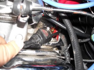

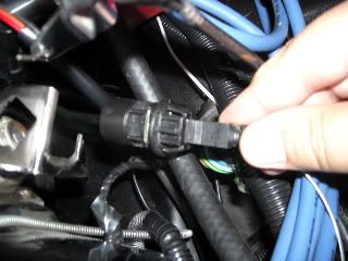

The tranny guy installed this kickdown bracket when I had the TH350 transmission rebuilt about a year and a half ago. Does anyone know how to adjust one of these?
Here's the top
and here's the bottom

The half moon looking button on top of the first pic, push down, cable inside should snap back. Hook up to carb and bracket that holds the cable. Get inside the car, push the accelerator to the floor and release. If the bracket and carb hookup are correct it will adjust itself.
#3 ·
Not snapping back. Looks like I need a new cable.
