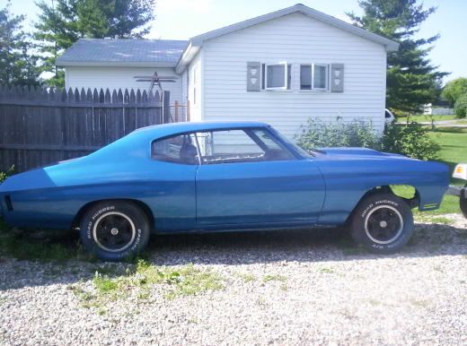

Here are some before pictures I have a lotta money tied up in paint and resto parts so I hope it turns out great. The guys in the picture are the guys painting the car. The older guy has been doing these cars since their production.
http://community.webshots.com/user/ssdungeon
Look under Chevelle restoration. Pics of some of my other cars are there as well.
