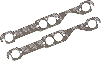

I've been using the Mr. Gasket Ultra-Seal gaskets for years. They have a steel core and work better than any others that I've tried. I've run the aluminum ones you reference and even solid copper with sealer. The Ultra-Seal lasts the longest. Of course you need to check the header bolts a couple times a year. And, my car is fuel injected.

I've never had any leaks with Fel Pro header gaskets on the carbureted engines I've had, but on the fuel injected blown engine I had back in 2006 in a street/strip car, I used Percy's "dead soft" aluminum header gaskets when I installed a pair of stainless steel Kooks headers, and after some drag strip use, and 44,000 miles, those gaskets never leaked either, right up to the day I sold the car. I might try these Remflex gaskets on my current build. They used to offer to send you a silver dollar sized sample of their header gasket material, so that you can see how different it is from other header gaskets.
The Remflex gaskets are thicker than others, and are very soft, and the material bounces back or rebounds after you squeeze it, or dig your fingernail into it. It retains it's former shape after you let go and take the pressure off of it. So the manufacture's claim is that these gaskets will follow the contour and shape of the head and header flange surfaces as they heat and cool/ expand/contract. I've never tried them though.
Remflex Exhaust Header / Manifold Gaskets
Another thing is that if you have heads that have rectangular shaped exhaust ports, and your header flange opening are round and/or the header gasket has round holes, then you might get a little bit of a mismatch which can invite leaks.

I will second the Mr Gasket Ultra Seals that Steve mentioned. Have never had an issue with them. But like somebody else mentioned if you header flanges are not fairly straight then it will be hard to get anything to seal up.

The key to leak-free header gaskets is to retorque those SOBs as many times as it takes until the gasket takes a permanent set. I hit them at least a 1/2 dozen times and I “get a little more” on them every time.
I prefer the cheap white ones as they come off easy and don’t brinnel the alum heads

On the advice of someone here, I did the same and haven't had any problems since. Get the engine fully hot and let it fully cool, then re-torque every bolt. Repeat until they no longer move. I also did this about a 1/2 dozen times after installation and (each time) before I hopped in it for a drive. Using paper with some high temp RTV.

Match your head port and header ports to exhaust gasket. I talking BB round ports or D ports. Most BB
Headers are round ports. Mix them up and the dreaded exhaust leak pops up. Tell tale sign carbon at headers edge to head seal. I think I used the FelPro performance exhaust gaskets.
This has always been an issue for me as almost all exhaust ports are "D" shaped, and almost all headers are round.

I've always had the best luck just using Felpro exhaust manifold gaskets. One side flat, the other side is made to collapse when the bolts are tightened down. I've never had one leak on me. I prefer the one's that aren't one long gasket, as I like not seeing the stupid gasket running along side the header flange, and causing clearance issues with the temp sending unit, etc.

You guys can laugh if you want, but all I use is copper sealant. I don’t get leaks, even with square exhaust ports and round header tubes on my big block. Every header gasket I ever bought failed eventually, even Remflex. I sold those at my store when they first came out, was a real believer in them.
