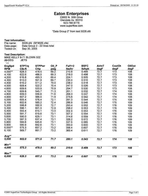

How are these numbers for a pump gas 8-71 blown 502 ci in a 66 pro street Nova ? 4.56 rear gears and 3500 RPM stall?

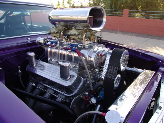

look at the BSFC, that thing is pig rich and getting richer all the time. What is your confidence level on that shop? Did they say anything to you about the carbs? Is there some kind of little tiny air filters inside the scoop?

Mike at Lopers built and setup new carbs. A few weeks later the car went back in and had a complete short block built and the heads checked etc.. I was told the dyno shop confirmed that the jetting was perfect. Was I lied to?
I am new to this. What does the BSFC stand for? And what do the current values exactly show? Is there a reference range?
The blower is 10% under driven with 4 psi
The carbs are 750 cfm ea.
What questions do I need to ask?

It does look rich, and certainly leaving a lot on the table. Why so conservative on the boost? Is this a race car, or a pump-gas weekend cruiser? Pretty car, btw.

OMG. Lopers? You really let Lopers work on that nice car? I thought their shop went out of business years ago. In the olden days (I have no idea who is working there now) I used to make pretty good money just fixing up carbs that they screwed up. It often appeared that they were reading the latest magazines and blindly doing to customers cars whatever was the latest hot tip at the NHRA Finals.
Yes, whoever told you that dyno sheet indicates good fuel metering/curve is either lying to you or has no idea. Lean is about .400, Winston Cup cars used to run at abour .450. I've seen several about .500, I've never seen one that went all the way to 600. Mainly, it should start off at 450-500 and stay there all through the RPM range.
It's Brake Specific Fuel Consumption, it refers to standardized method of measuring fuel use efficiency. It's pounds of fuel used per horsepower per hour or something like that. Anyway, it should never get up to 500, much less 600. I wonder what the guy did to those carbs, they'll do better than that out of the box.

Who would you recommend to RW dyno and tune the car? Is is salvageable? How much more will I gain with a proper fuel curve?

Tom's right, a good motor will have BSFC #'s in the low .400's, some .390's. Not sure if that still applies to a blower motor though. I was thinking they ran a bit higher, say .450-.500ish, certainly not .600 though.
A fellow TC'er here in Houston dyno'd his BDS 8/71-502 and made near 800hp on a pump gas tune-up on what's considered to be a conservative dyno outfitted with DEPAC data acquistion. FWIW, I'd say you've got another 50hp in carb tuning, minimum.

Gotta agree. I'd swap pulleys top to bottom and build some more boost. Then see what carbs do. They are rich, but better fat than lean on a blown pump gas motor.
The HP wasn't completely done yet..it was still climbing some. I assuming cam is a hyd maybe and that's why they shut it down around 6000?
I'm sure 800 range is doable without much work if valvetrain is stable.
I'm with John...I'd stay up near .500 just to be safe for a street motor. I've seen high .300's on some VERY WELL developed engines that are on the edge....not something practical on the street.

Almost out there for small blocks, under development for big blocks. Haven't had one on the dyno yet. The small block stuff works very well. Spent a lot of time trying to get even A/F distribution too all cylinders. Cylinder to cylinder A/F is something most people don't realize varies a little to a TON, so going richer (higher BSFC) ain't always terrible, you lose power quicker going too lean than too rich.

I assume your using the low compression 502 shortblock as a base, though im not sure what cc your cylinder heads are, 4 psi is very low. I dont see why you arent running 6+, it would certainly build a lot more torque. And with the carb tuning, you'd be well over 700 hp, and I'd predict a bigger gain in torque.
