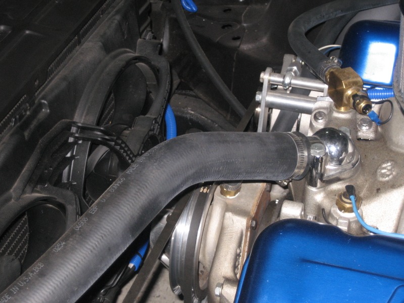

4) Fan too small or not adequately shrouded. It needs to cover as much of the core as possible and be mounted very close to the core. I use two smaller fans in mine with a shroud that covers most of the core as can be seen here.
Tom
