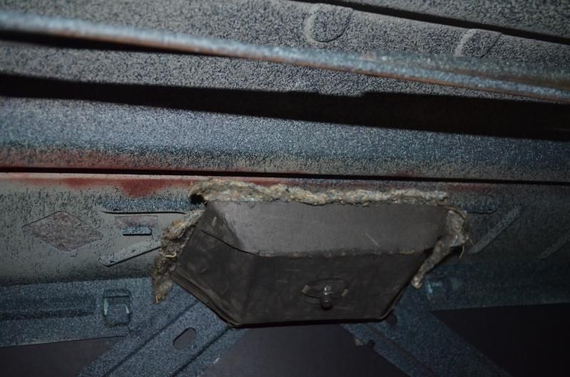

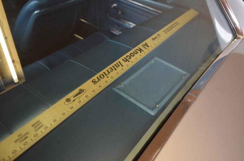

hello this is what I believe to be correct. my car came with this option but I did not have any of the parts when I bought the car besides the rear fader switch. I got the speaker grille from Hinshaws Chevelle parts. and the speaker cover from a mid 60's big GM car from a junk yard. it was taken off a car a long time ago and stored inside. James a Larson here on the forum has this option as well. he sent me pictures of his set up when I did mine. but I did not save his pictures.

Thank you for posting the photos. That is a big help. I did purchase a speaker grille on ebay that I thought was correct but mine is more oval shaped. When I get home I will post a photo of what I have in case someone has an opinion. I don't want to put the wrong part on the car. Thanks again. Bill d

All factory installed 66 Chevelle rear speaker grills were rectangular. Not oval. Regardless of build date.
All dealer installed 66 Chevelle rear speaker grills should be rectangular. Not oval.
However, if the dealer grabbed the wrong rear speaker accessory kit, theoretically he could have installed a left over 65 kit with an oval grill. But that should not be possible either, as the kit contained the fader switch and knob, which were different in 65. So unlikely the dealer would use the wrong kit.
