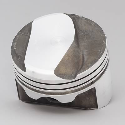

Without doing the math, the 781s vary in chamber size.....I'd bet the planet that with the .210" domed slugs, chambers 119cc...you'd still come in around 9.8:1. What I'm saying here is that your RECT PORT OC heads should have the same chamber size (approximately) as the 781s. Maybe a tad more Zero-deck. Let me run some numbers tomorrow..... Remember, the pistons give a bit over 11:1 with 106cc chambers.
