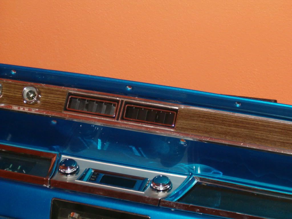

Gen IV unit
acquired a 67 Malibu dash strip for an AC car (I like it better than the 66 strip) aand cut the dash to fit the VA vents------the vents are actually behind the dash strip, but they look okay

4,522 Posts
Bryan
i like the idea of heater hoses being accessible. do the still run inside the fender going forward or is the pic just not showing them? thanks for the pics and the input.
