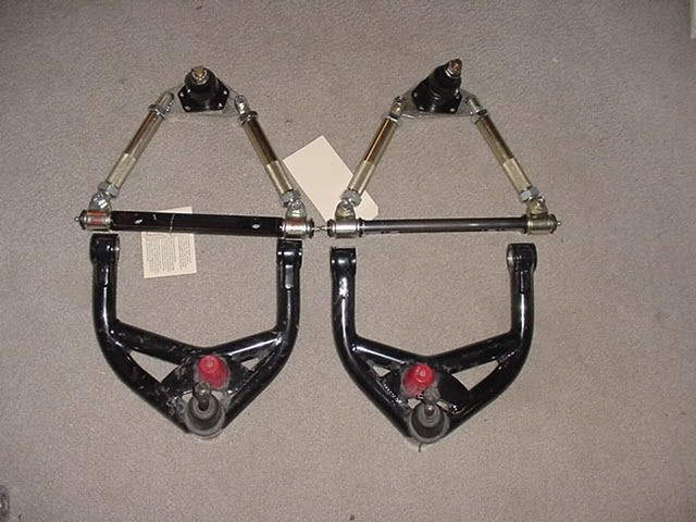

Option 1 : install SPC uppers and the no bind ball joints, sell the Global Wests.
Option 2 : sell the SPC uppers and no bind ball joints, buy the del alum bushings ($150) and the 2 billet shafts (63$ each)
(my setup includes AFX spindles and I will get the GW lowers later on)
What would you do ?

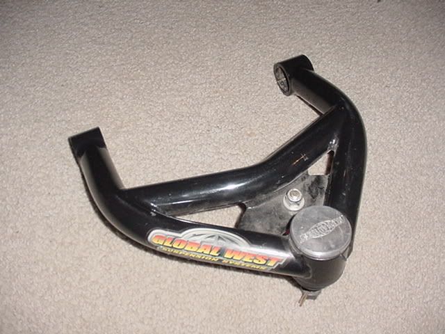

The global west stuff is defenetly top notch as far as quality goes. Not that the SPC stuff is bad but you can really see the quality og the GW arms when you hold them. I cant wait to get my global west lowers :D
464 Posts

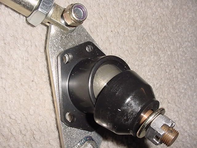

Why would you sell fully adjustable,race proven arms that are lighter in weight and have simply the best ball joints available anywhere in favor of non adj. arms that are heavier than stock and have cheap parts store ball joints? Seems like a no brainer to me but I admit it`s possible that I could be slightly biased. :thumbsup: Mark SC&C
514 Posts
I sold the GW's last night. The SPC and ball joints I bought from you guyz ;)

How strong are the SPC arms compared to G West arms.This would be for a street application that gets beat on pretty hard. I know they are heavier but the ones from Global are stout.
Having handled both I would say that the GW stuff appears and feels much stronger that than the SPC arms. It's also a lot heavier. But I am pretty sure the SPC stuff is plenty strong to handle street duty.
Maybe other will chime in on this.
514 Posts
Discussion Starter · #20 ·
The adjustability of the SPC arms makes them hands down 10x better than the global west. Keyword no more shims. Also, the loads applied to an upper arm are minimal since all it is required to do is locate the spindle not support the spring load.
