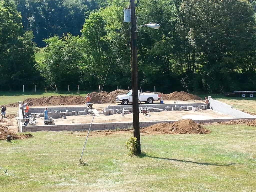

Here's what was going on when Deb, Sam and I were thrashing on the cars at the Ohio Musclecar Challenge.

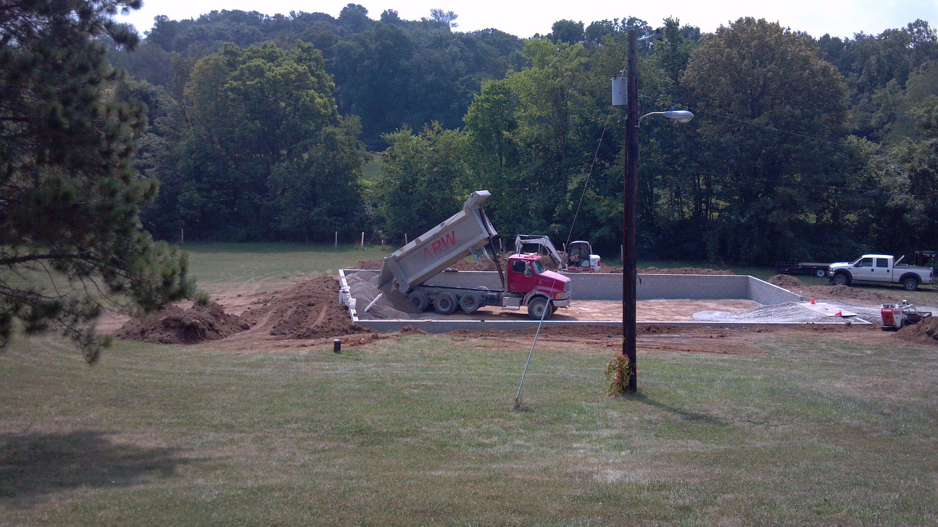

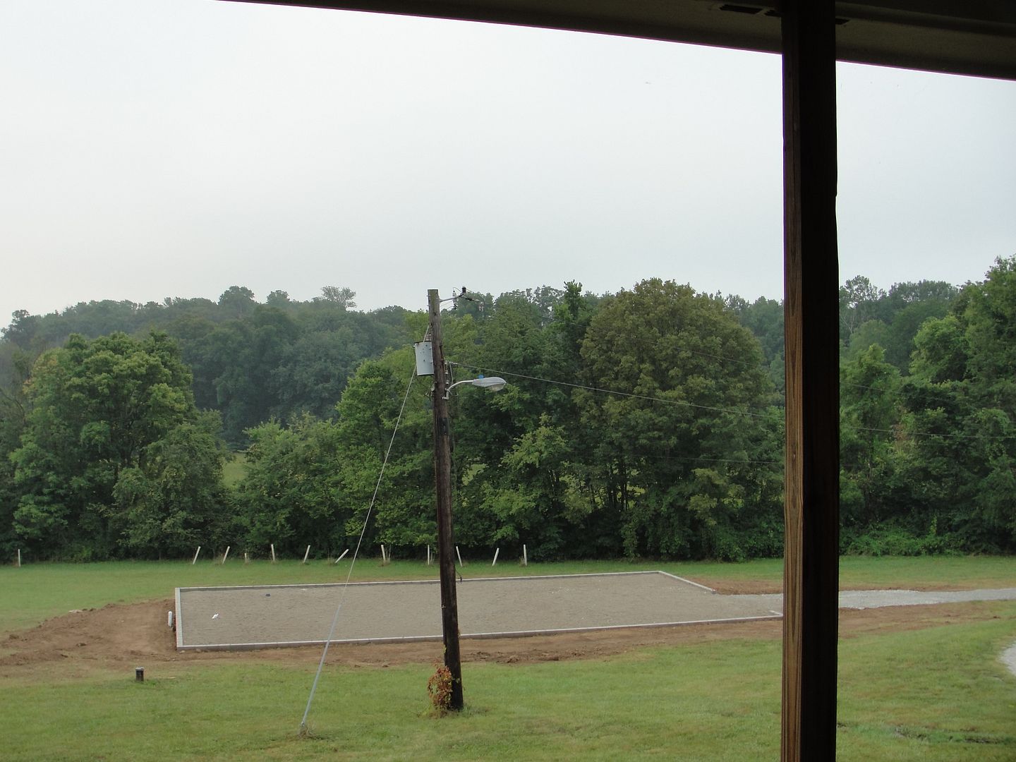

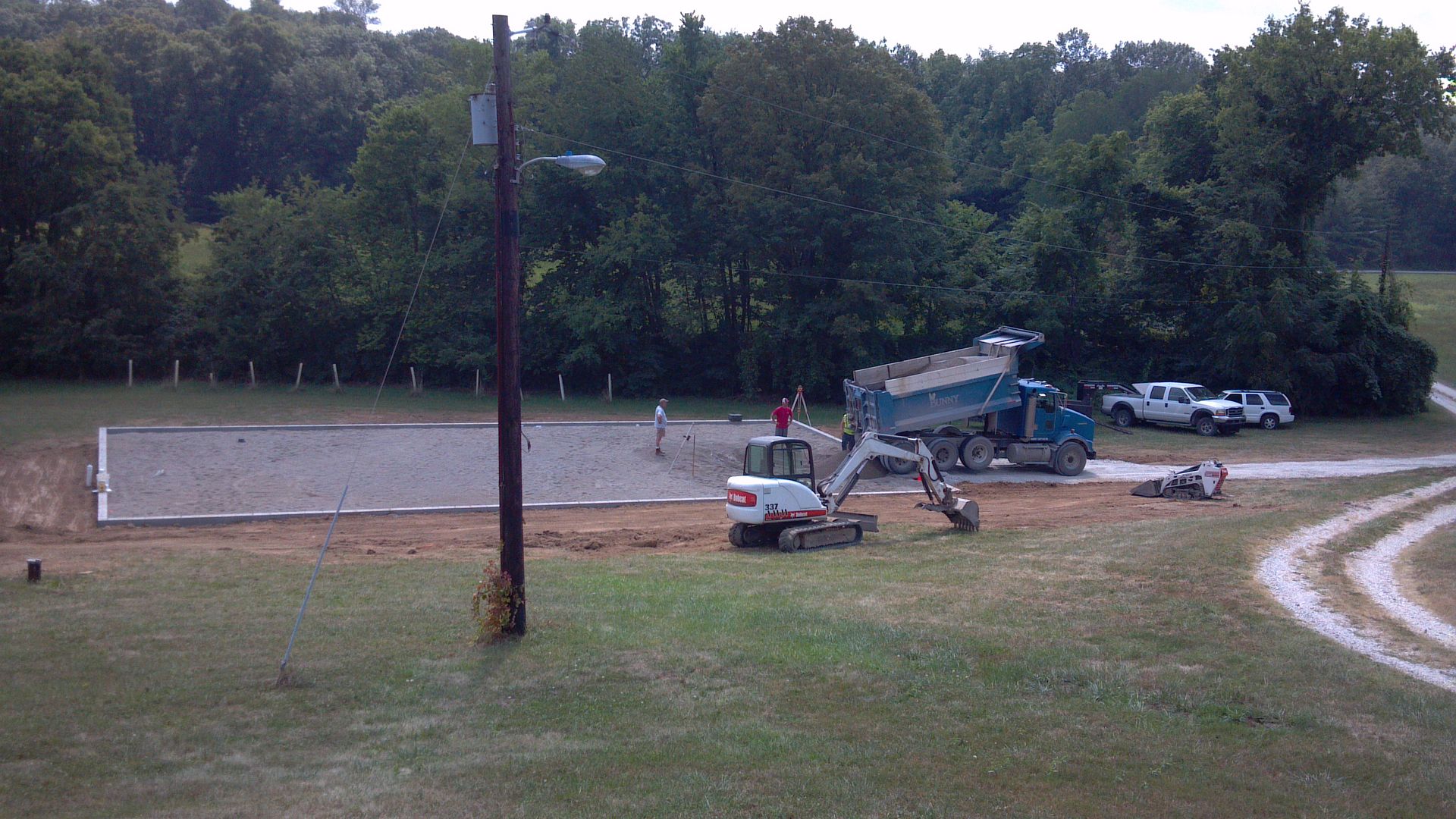

Lots of pea gravel fill while I was out of town last week.
And this brings us up to date. I should be meeting with the flat work guy today and if all goes well, we will be pouring tomorrow. Having been in the building industry for a while, I won't be surprised if that gets bumped to the right a little.

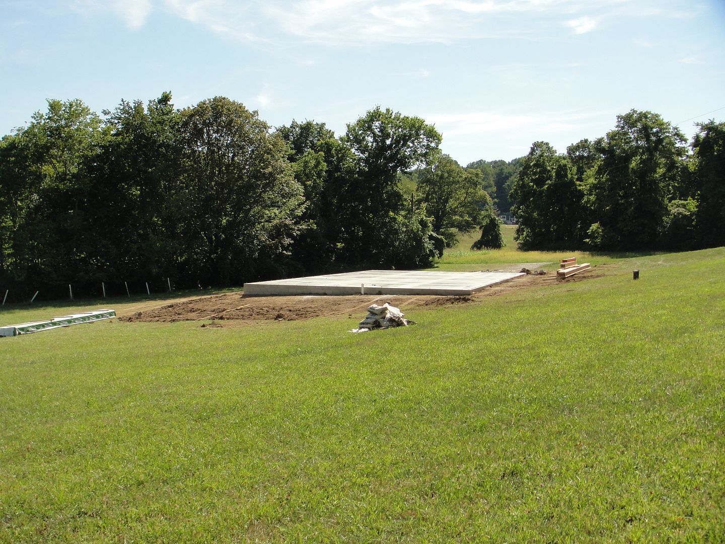

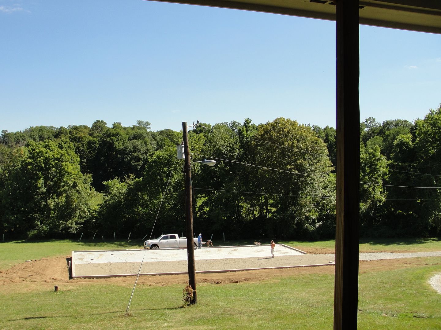

Just as promised, the flat work guy came out and checked the grade of the pea gravel and spread the visqueen. They will be back at 6 am and start pouring at 7:30. Pretty exciting!

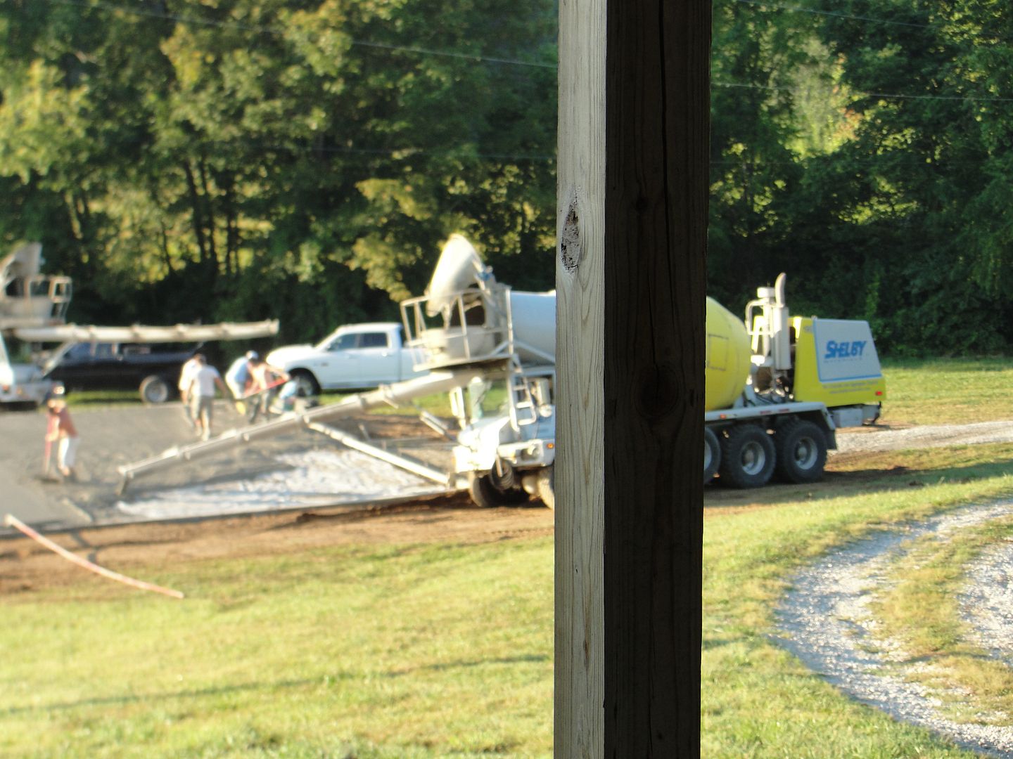

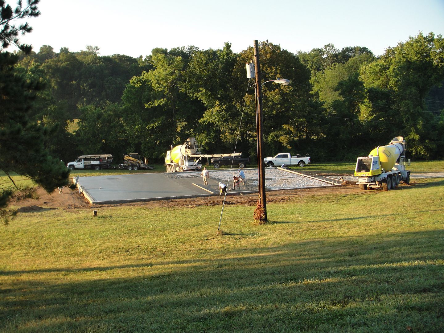

Just as promised the pouring started early on the morning of 9-04.
Here's the less than cautious clown that drove too close to the foundation and broke out some of the blocks. A few years ago I may have lost my cool, but in the end it would have solved nothing. The flat work guy came up with a solution for the repair and we agreed it was the best option.

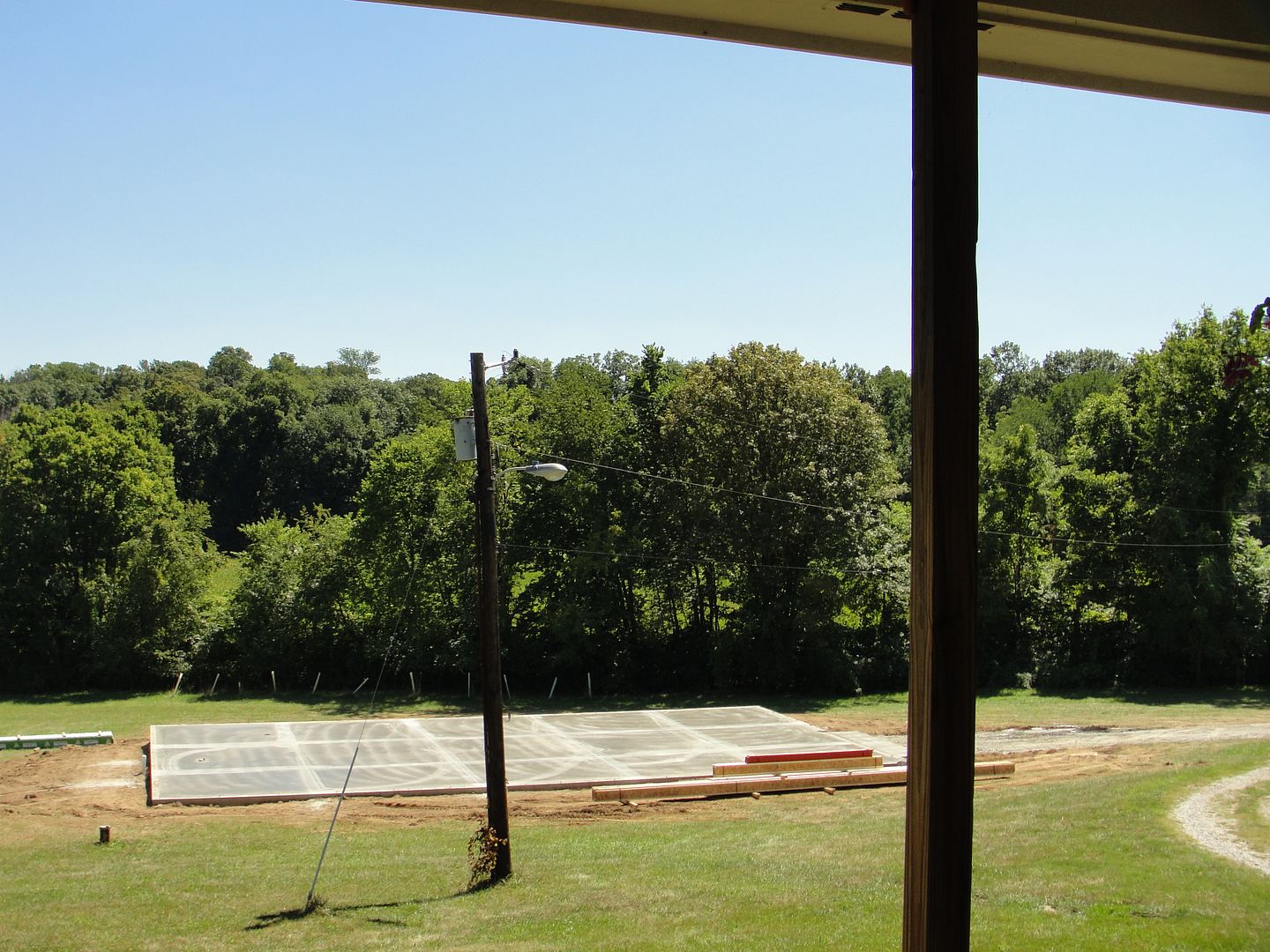

Concrete poured and relief cuts done by the end of the day. Also had the engineered floor joists delivered for the floor and also the rafters for the same area.
Here are a couple of pictures that give a better perspective of the grade we had to deal with.

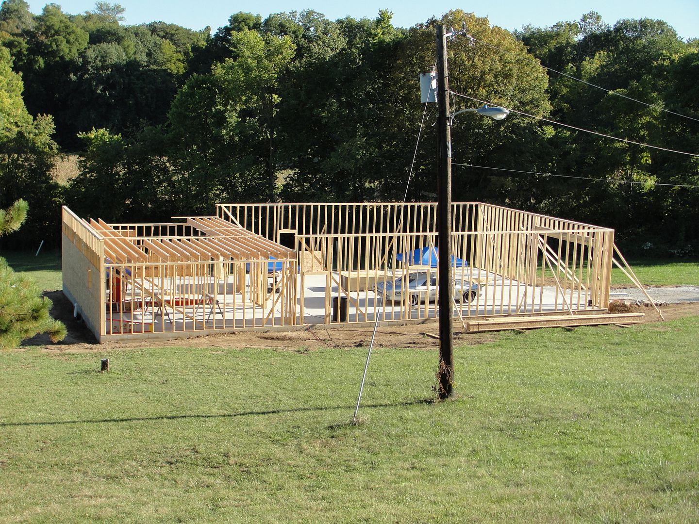

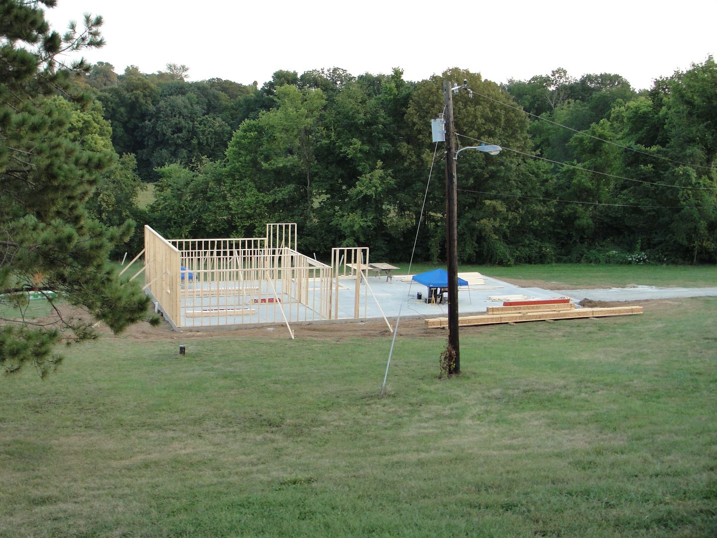

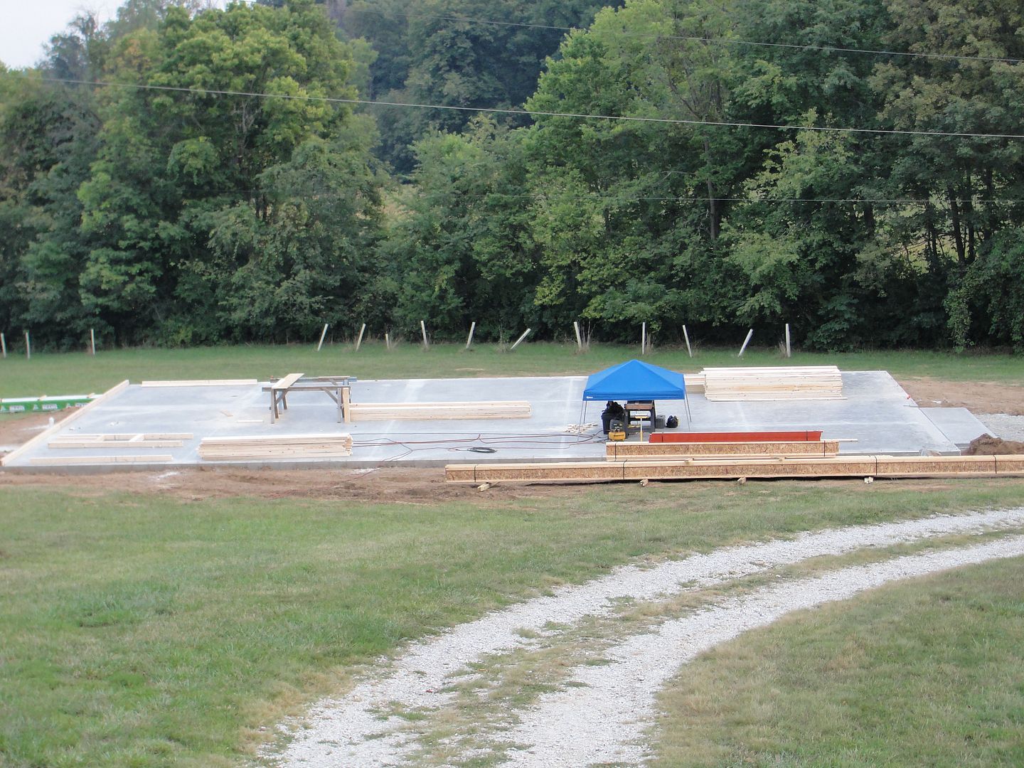

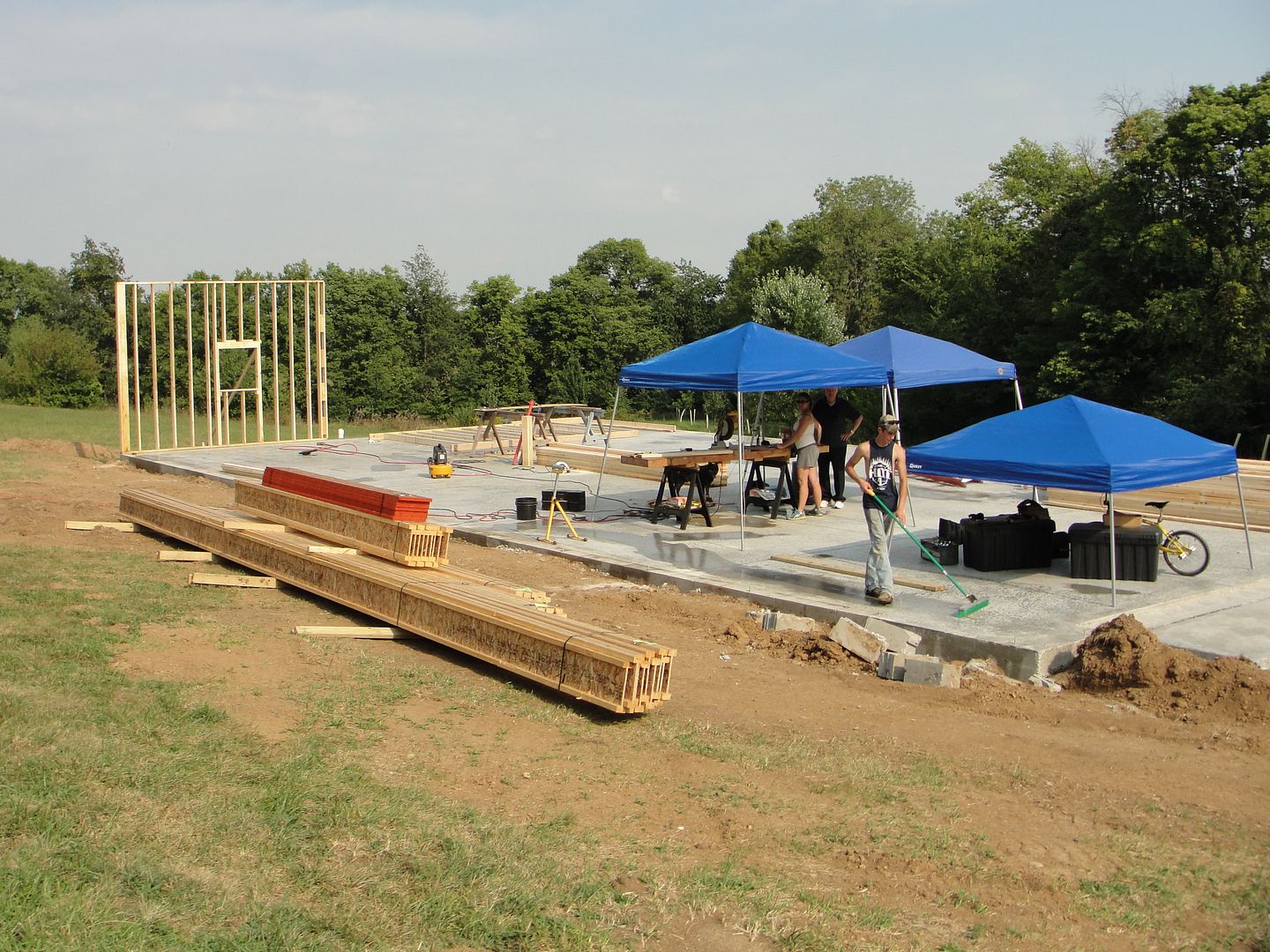

Our trip to LS Fest was cut short mid day on Friday due to my part time job. Once that obligation was met we took advantage of the situation to pick up lumber and start to lay walls out.
Hopefully more updates tonight!
6

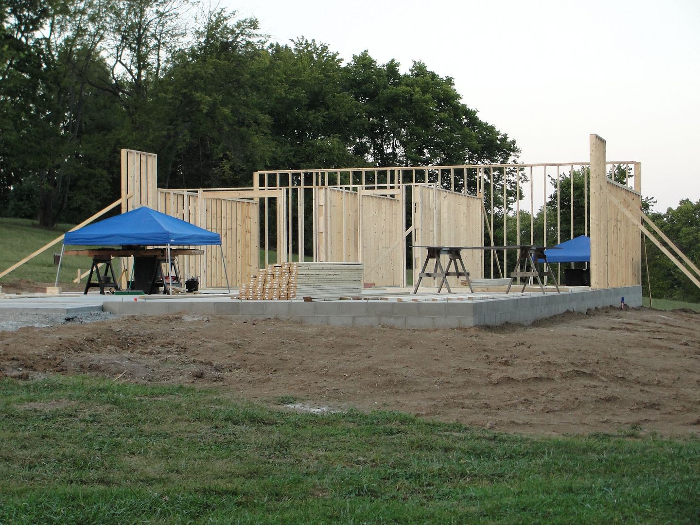

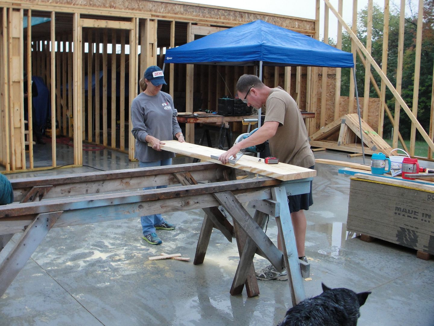

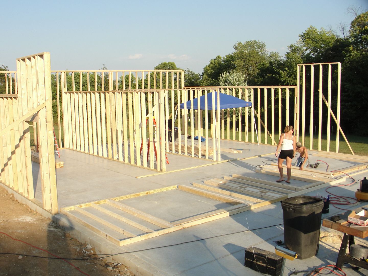

My framing skills are a little rusty, we had off and on showers until about 2 and my whole family dropped by (I'll never complain about that) so we didn't get as much done as we had hoped, but any progress is good progress!
Sam taking a break to sweep off the water while Deb talks to my dad. Oh yeah, first wall up!!!

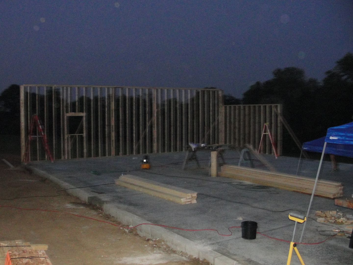

Dark enough to call it a night.

I always think we should be making more progress than we do, but a couple of jobs, two cars to maintain and a buddies to work on and there are still only 24 hours in a day just limits us...
Deb and Sam getting it done. Don't bother with your safety comments on our work crew, I can't control everything! We're doing well with safety glasses, but Deb in flip flops is beyond my control.
Progress at the end of the day yesterday.

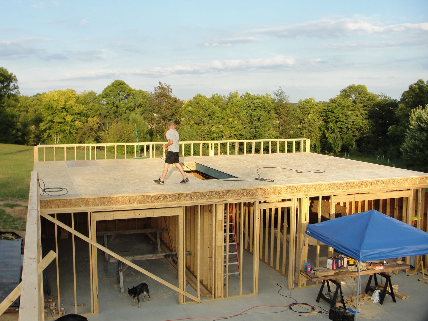

Somehow I keep thinking that I am doing pretty good with updates, but apparently I fell behind again. Work has been demanding but we're still making pretty decent progress. All our car projects need attention, but the buyer of our former shop indicated that he will soon have the remainder of the money and want it sooner than later so it's thrash time to get this place under roof.

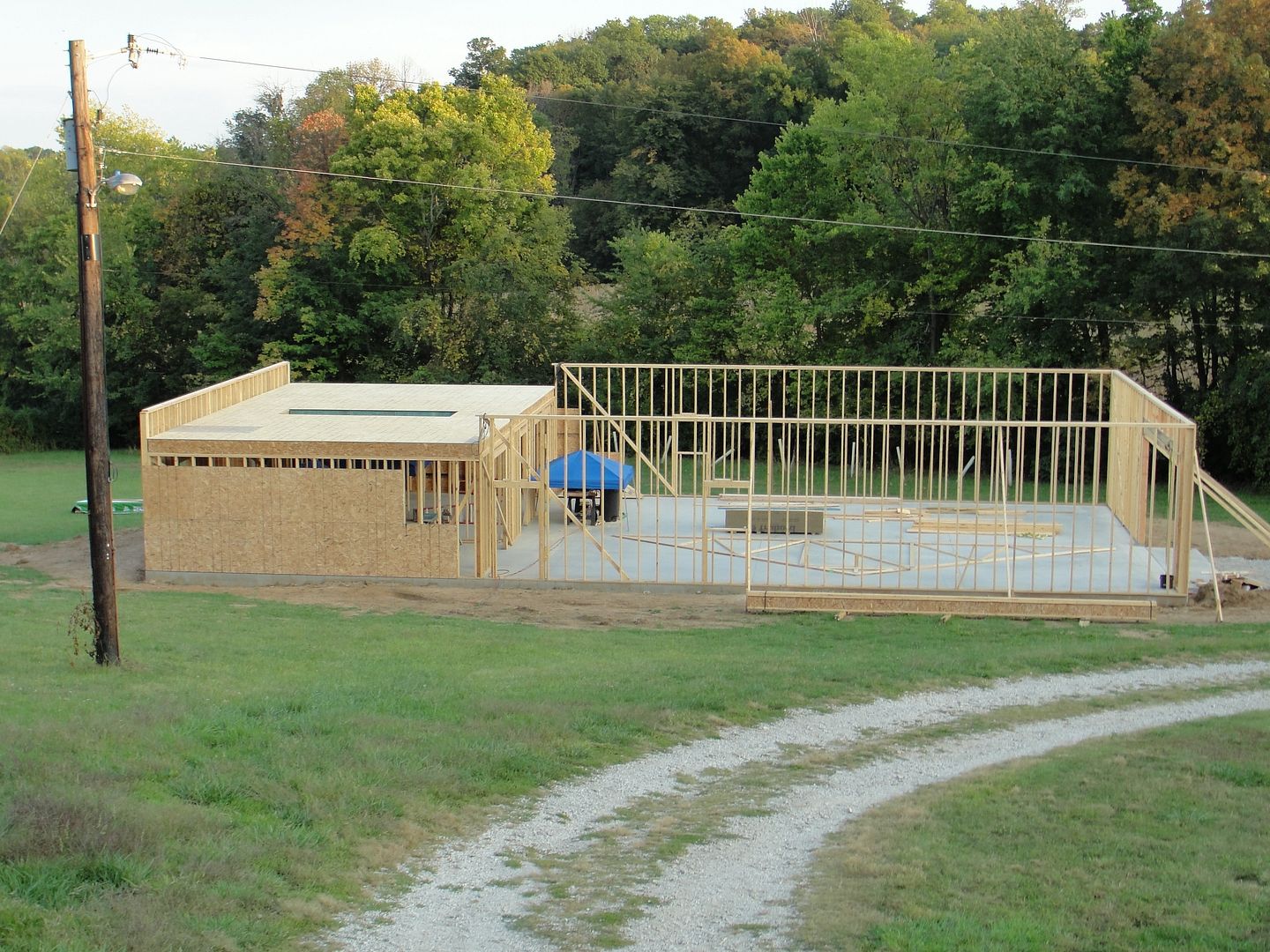

We left Goodguys Indy early on Sunday so we could get home and get some work done. The last of the wall construction was building the two 4' walls on each side of the garage door and install the header. We used our John Deere to lift the header to 8' (max lift of the bucket) while Sam and I lifted each end the remaining foot. All was well until we shoved the last side in. Even though I had never done it before, I used construction adhesive in the pockets and that made things very slippery. Well... As we were shoving the second side in, the first side slid out and bounced out of the tractor bucket and smashed the hood of the poor John Deere. Also glanced off Sam's head, but he's fine. After we all settled down we were able to install it with a few more safety measures in place.

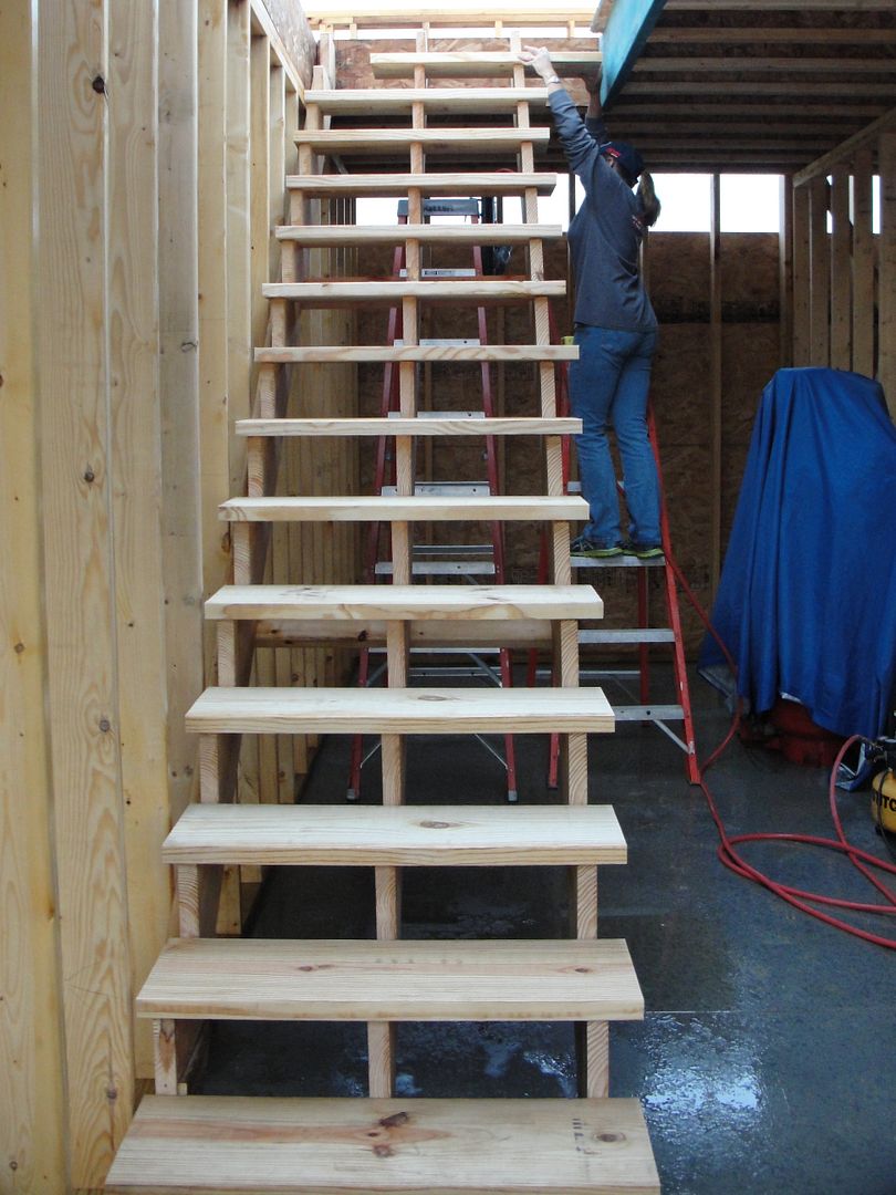

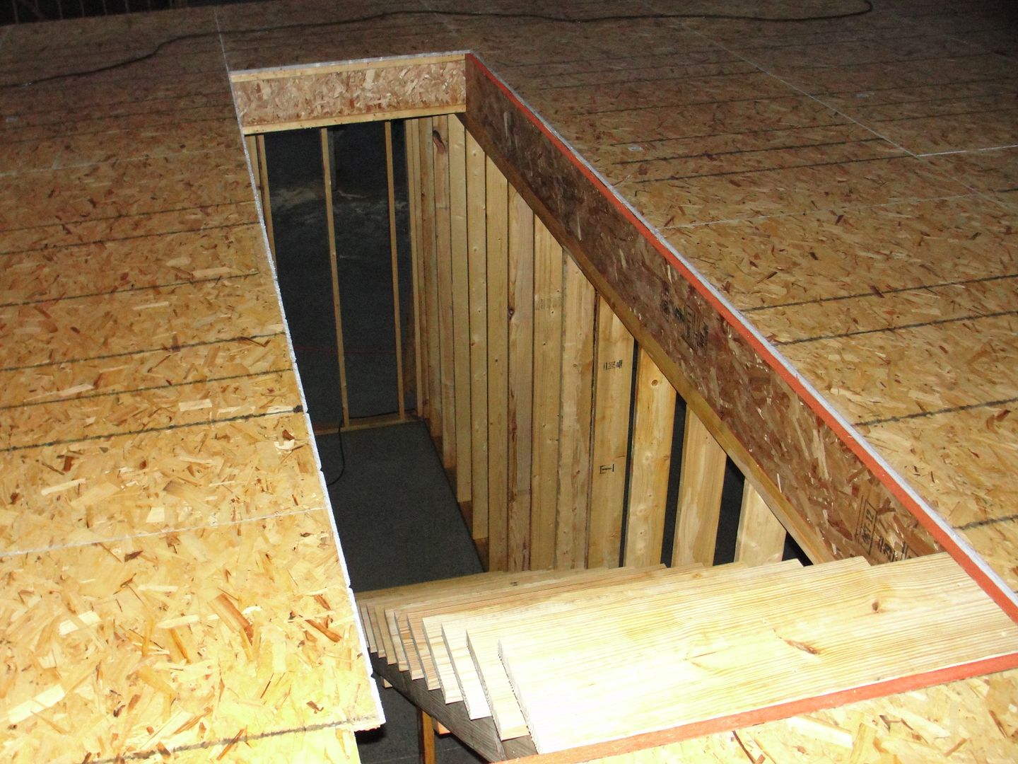

Rained all day, but Deb, Sam and I were able to get the stairs completed today. Normally we build stairs at the completion of a project, but I figured with all the work that needs to be done upstairs this would save us time in the long run. The guy I worked for framing houses many years ago never taught me to build stairs, but I watched him more times than I can count and luckily I picked up a few things.
