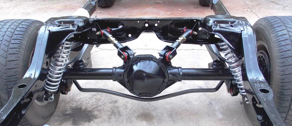

I noticed that you are looking for a suspension kit with coil-overs possibly.
We have some great parts/kits that work great on these cars and we are developing more for the future!
Here is a install article that the folks at Chevy Hi Performance did on our Level 2 kit:
http://www.chevyhiperformance.com/te...l/viewall.html
I can also put together a upgraded Level 2 kit with coil-overs (see attached pictures) at all four corners as well:
