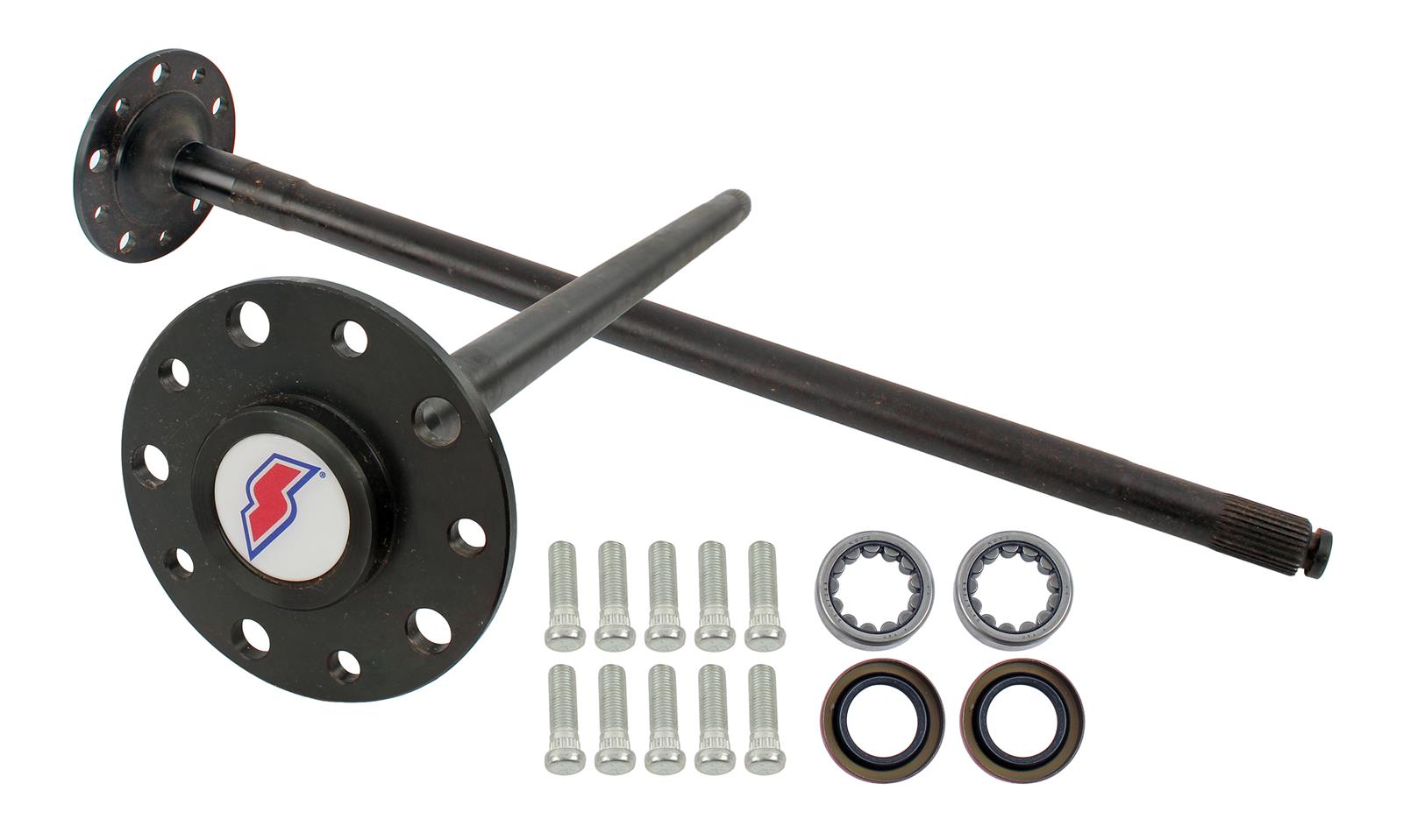

I was originally looking into these from summit, along with an aluminum rear differential cover with the load bolts that support the caps.
