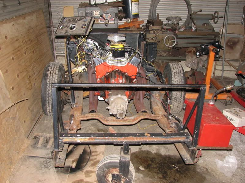

find an old subframe cheap 50-100 bucks and build a start cart like i did!! i use it to break in new engines etc..
this an old 68 camaro frame
here is a video of it with a new 327
i use an empty trans for mounting stability, I think i have about 200 bucks in it total from a bunch of parts and scrap i had lying around!!

that sub frame idea is great! i would have never have thought of that! just gotta have enough room for it.
