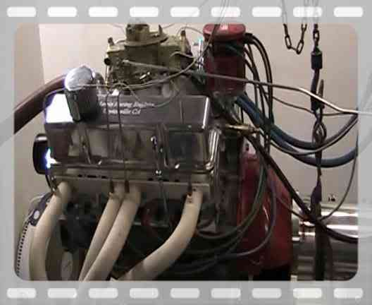

For the mini motor guys here is a very mild hyd roller mouse, 10.2, 337 inches
And there is more here, carb is pretty rich ;)

We can see they are AFR heads, I would think they are the 195 eliminator heads.
You would be wrong ;)

337 with AFR 180 heads, 218 cam and 600CFM carb. 429HP, 415tq, that is freaking crazy.

Thats close to my combo except my cam is hft voodoo 60102 I also run 1.6 rr most of my dyno sims are between 395- 419 hp of coarse thats just a guestimate.
This does not suprise me one bit. Those 180 Eliminators and that Stealth intake can haul the mail.:yes:
That sure proves the (AFR's run good with a single pattern cam) theory doesn't always hold water.

That is the specs I wanted to see, that thing is a nice little piece! I bet it will scream and get killer fuel mileage.
All we hear about on here is the BBC stuff, about time we have a killer dyno sheet on a little motor.
The small cams sure do hand on good when supplied with good heads!
I am going to try one of the small cams on my next street build, typically I am going for over 500hp, I want to build a very tame 450hp motor this time!

It's pretty tame & it had about 16" of vacuum at 1000 or so as I recall,,, should be a real nice driver,,,,
Looking back I don't know though,, I used Comp lobes,,,, didn't put them on a 106,,, lot of "experts" say this won't work,,,, :D:D
I have video now of the dyno run:thumbsup: 429H.P 415 TQ (60 over 327)
