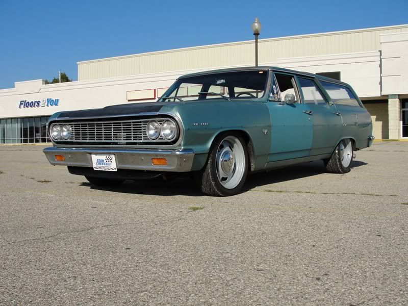

Well this 64 Chevelle wagon is hardly a new project to our family and many of you have seen it at different events over the years, but we figured it was time to start a build thread so people can see the big changes we’re making over the next few years. Sometimes we think build names are overdone but this one seemed pretty catchy so we’re going with it.
Some folks probably have been following along with our 66 2-door hardtop Pro-Touring build and know it has been our main effort for the last 8 years. The wagon was bought in 2003 when we realized that the 66 was going to be a long project. Even though we’ve made some huge improvements since we bought it, we’ve continued to drive it and enjoy it.
So, here’s where it is right now:
