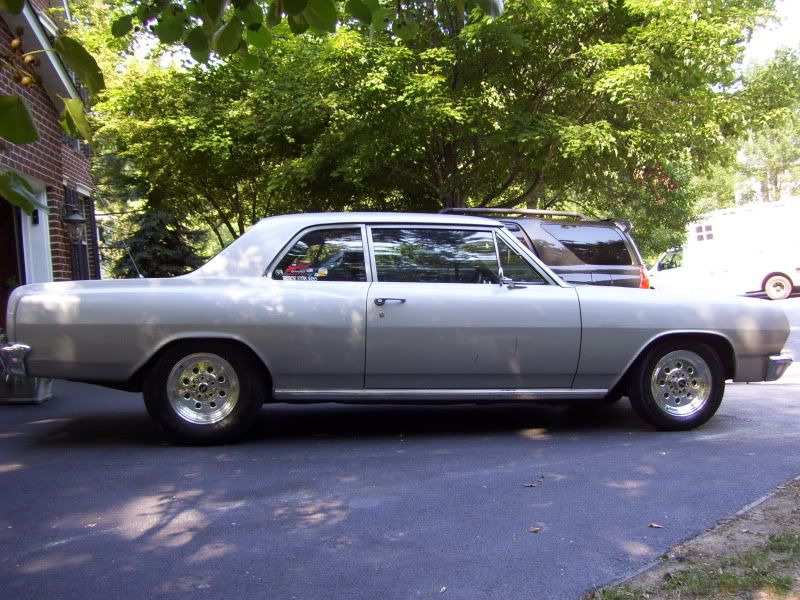

When it arrived to my house and how I left it over 16 years ago. Looked the same.

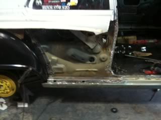

Full floor, full quarters, inner and outer wheel houses, etc, etc. Everything else is being stripped down to bare metal at the moment.
Because full quarters for the 2dr post are almost impossible to find, coupe quarters were purchased and had to be modified to fit the body lines. The C pillar section couldn't be used.

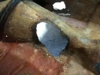

Yep, this car grew up with me in Arizona, but yes, things rust in the desert...
Old Floor:
New Floor:
Speaks for themselves:
Had to alter coupe quarters:
Thanks to the guys at Carlisle Customs and Classics for doin' the body work for me. With constant military travel taking up most of my time, this would have taken me forever!! I am looking forward to getting the car back in my garage though so that I can start plugging away at it again...
