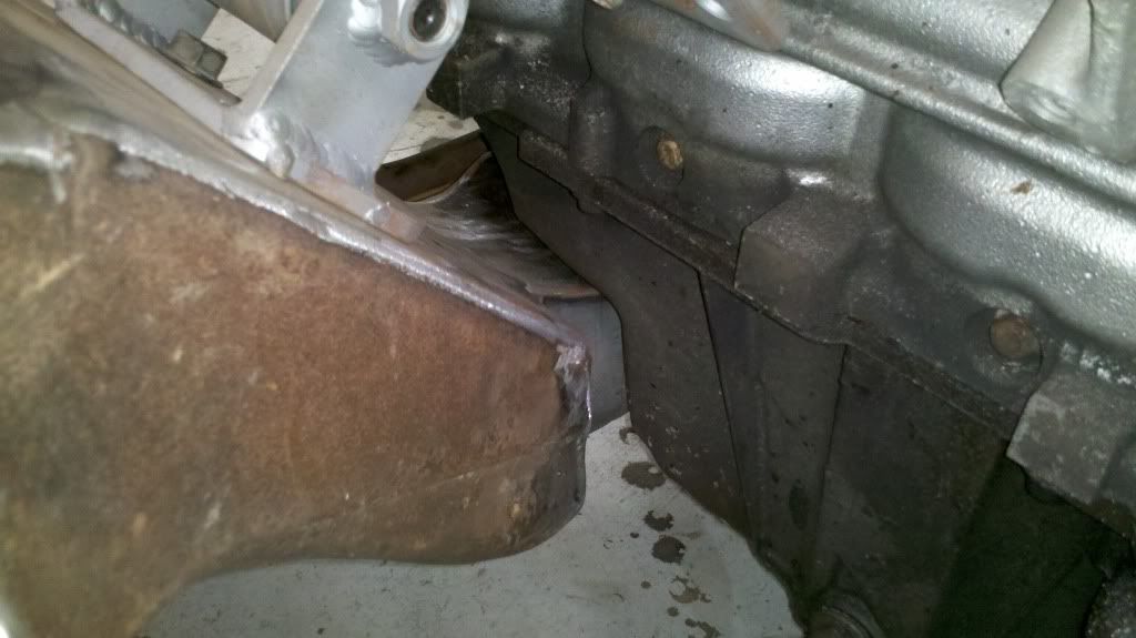

Small update, been doing some more mock up for the motor/tranny and crossmembers. After notching the front crossmember for F-body oil pan clearance, this is the first time I had the motor set back in. Looks like pretty good clearance with the possibility of moving forward a bit more if needed. Also, I didn't realize when I made the notch in the frame, the oil pan is not symetrical on the lh and rh sides. The rh side actually hangs out a bit further, about 3/8"-1/2" or so. Even with the difference, I still have plenty of clearance.
Here is the lh side clearance
Rh side clearance

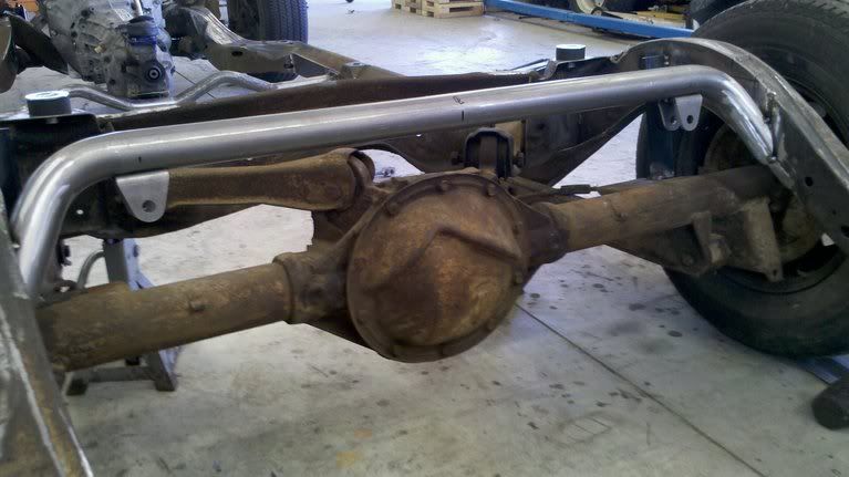

Another small update, but progress none the less...
Got the rear coilover crossemember fitted and tacked in position. This is a weld in kit that replaces the factory spring pockets and shock mounts.
Final welding will take place after I've sourced the rear end and wheels too.
Here is it tacked in:
