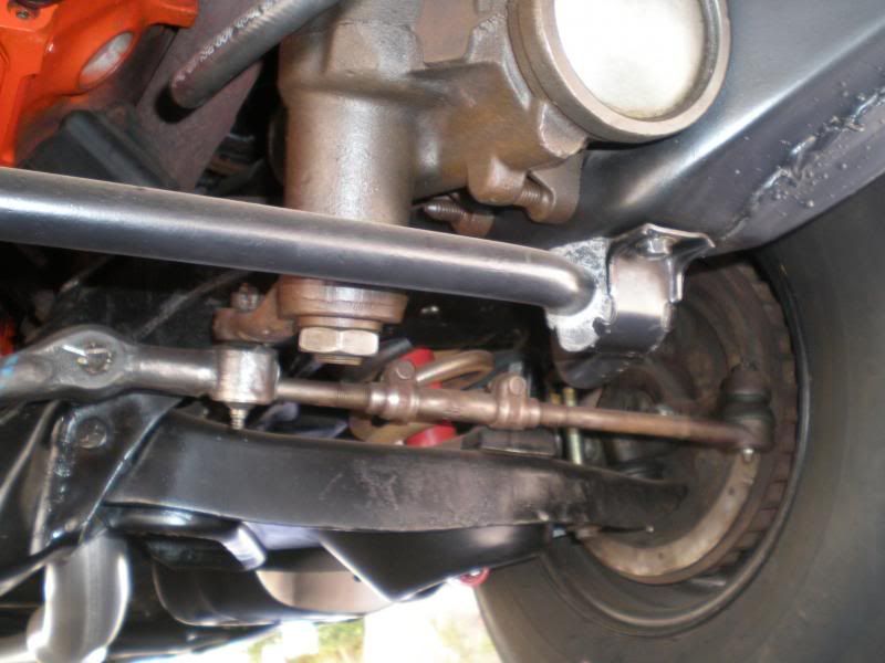

What are the correct colors or finishes for the pitman arm, nut and lockwasher for a '68 Chevelle with power steering? Thanks!

I usually spray the pitman arm with cast-blast, the washer with flat black to replicate black oxide, then silver zinc plate the nut..
