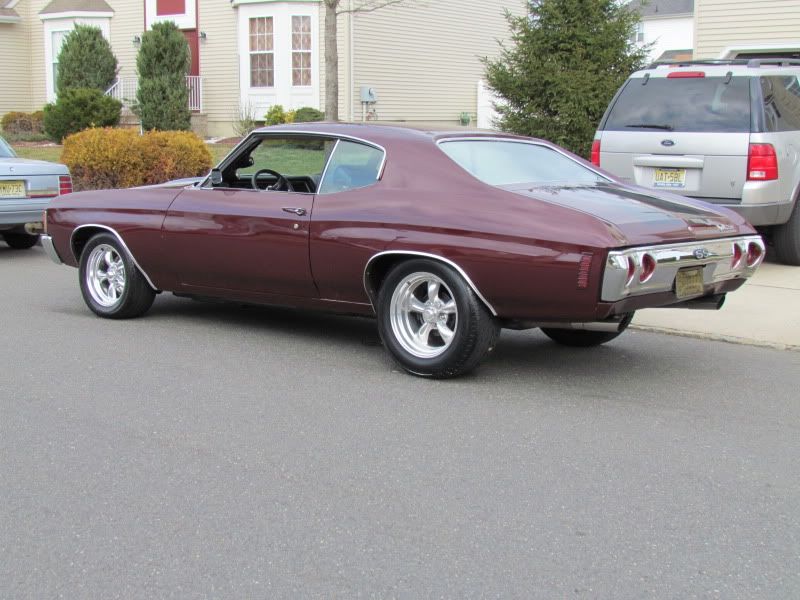

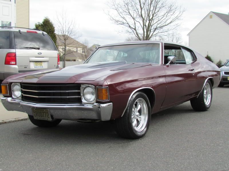

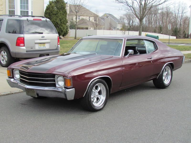

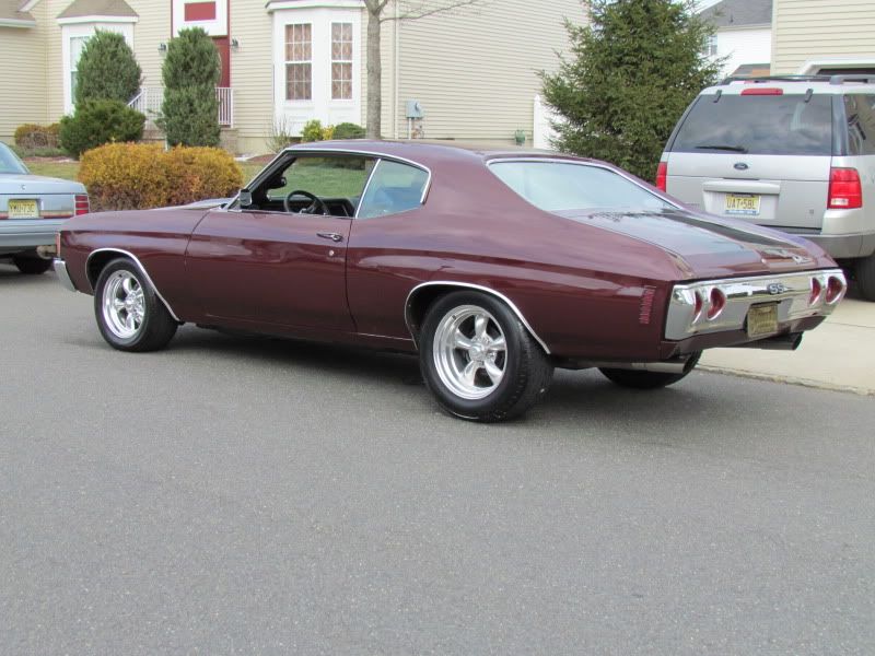

looks nice but you description is wrong in reguards to the width.
275s tires will never fit on a 5.5" wheel, the same goes for a 245 on a 4.5" in wheel.
According to summit the narrowest TT2 in a 17" wheel is 7 inches. I would guess you have 17x7s and 17x8s.
Maybe you have backspacing confused with width?

Sorry my mistake, yes the back rims are 17 x 9.5 with a 5.5 backspacing and the fronts are 16 x 8 with 4.5 backspacing
