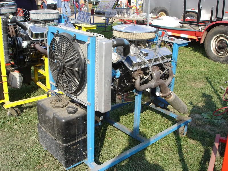

like this?
Yes something like that one. I found lots of pictures on Google. But would like to see if some one has a set of plans from one they built. I could draw one up. But if one is done already with the correct dimensions it will save a some of work.
Thanks..

ok I will check it out..Thanks..
You have PM.
Yes the one downtown is like that one..:thumbsup:
I have no block to mock one up. The 355 is in the car. The 406 is still at the builders. Could go down to the Speed Shop here and measure up a display they have. Lots of good ideas coming in..THANKS..:thumbsup:
Really surprised no one has a set of plans. When I get this thing done. I will post plans..
