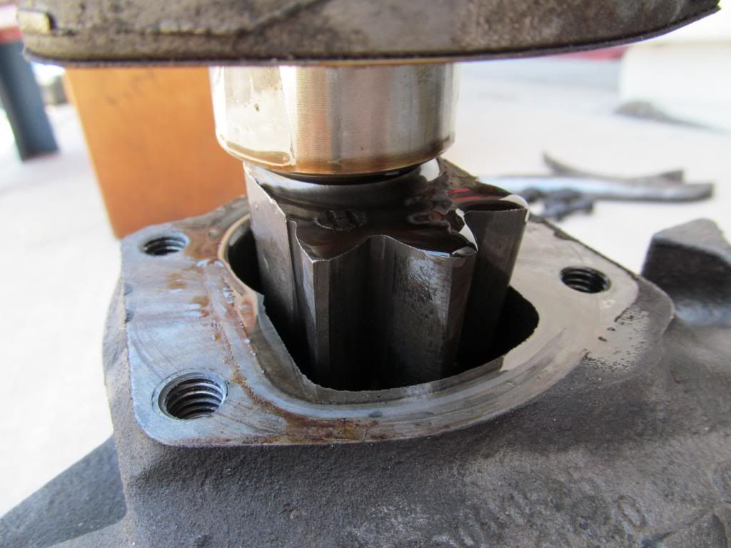

The new stering box has the same travel as my 66/67 box. The new box is 3.25 turns lock-to-lock. I want to know if this is a fixed ratio or a variable ratio box. Can you tell from this photo of the sector gear?

Variable, IMO it is a better feel than the quick ratio boxes. More stable on center but turns quicker once off center.

Thanks, Philip. That is good news. I was hoping it was variable. I was trying to remember the difference in the Sonoma after the box was changed to the ZQ8. The ZQ8 has the same number of turns, but I think I remember that the response was quicker and firmer. So along with the fixed fast ratio, I think the ZQ8 had a larger diameter T-bar. I think this variable unit is just fine for my EC. I Think I will use it as is, with the Lee adapters and a different rag joint, unless there is a way to put just the sector shaft and rack piston in an original box and keep everything else original. I don't necessarily want to change the T-bar, I think the variable would be just fine with the original small T-bar.
