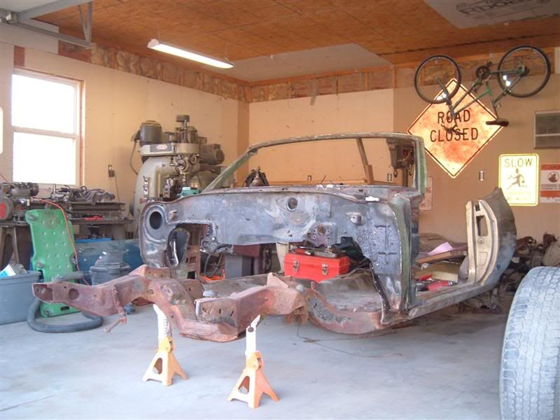

I choppered my 72 vert in half today
25865 Views 166 Replies 37 Participants Last post by  68C427GO!
Cross braces are sooo overrated!

I have done the same thing with my 71 convertible. I got a cowl section from another car, bought a new floor with rockers, and have reassembled it. It is currently held together with screws. I reinstalled the convertible top frame to check alignment.
I had to use ratchet straps attached to the top of the cowl to pull the top of the cowl forward so the convertible top would fit the top of the windshield frame correctly.
My question is, how are you going reassemble and brace the firewall section so that when you weld it out, it does not flex, and the convertible top hits the windshield frame correctly?
You guys will see more in my next few posts.... Careful measuring, planning, drilling the right parts to ensure it all fits back the way it should and have metal to weld to. (making sure im not drilling into the panel I want to weld to.
The cowl section wont bend or twist, it can only fit in one spot, then weld my cross braces on. Before the cowl is welded solid, the doors will be on it also.
It won't bend or twist, but it will move back and forth.
Please keep us posted on your progress, I would like to see how you do it.
Thats right it only goes back and forth,,,, I took some really detailed measurements of where it needs to be.

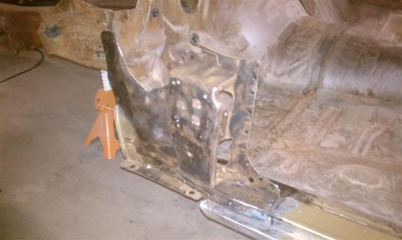

Here is the left side of the donor body, this is with the post and cowl removed, the other parts you see (these are ROTTEN on the vert body) were not cut, the inner lower hing post and the piece where the lower fender bolts go. Im going to cut (off the convertible cowl) about 4 inches of my hinge post and about 6 inches of the outer cowl off due to rust. This is why I saved the donor pieces....
The left side is the worst! Im off to start on the right side and get the floor trimmed up....

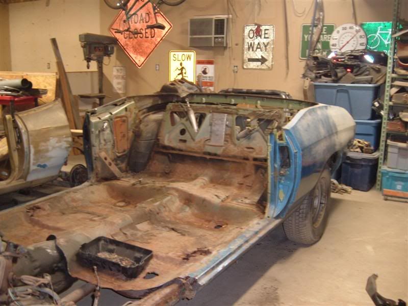

I may need a hand with this, LOL So far I got around 25 hard hours in this. The firewall needs trimmed up and some minor patches here and there. I put it on just to see if my measurement would be close, it slipped right on and stays there by itself. Not even messing with it, its within a 1/4 inch of where it needs to be...
This is basically what I did on my 68. I replaced the firewall too. Even after a lot of careful measuring it seems like I will have to use some gentle persuasion to make it all fit back together.
It doesn't take much, I got it fitting to all of my measurements real easy but this will be a almost complete car before any welding....

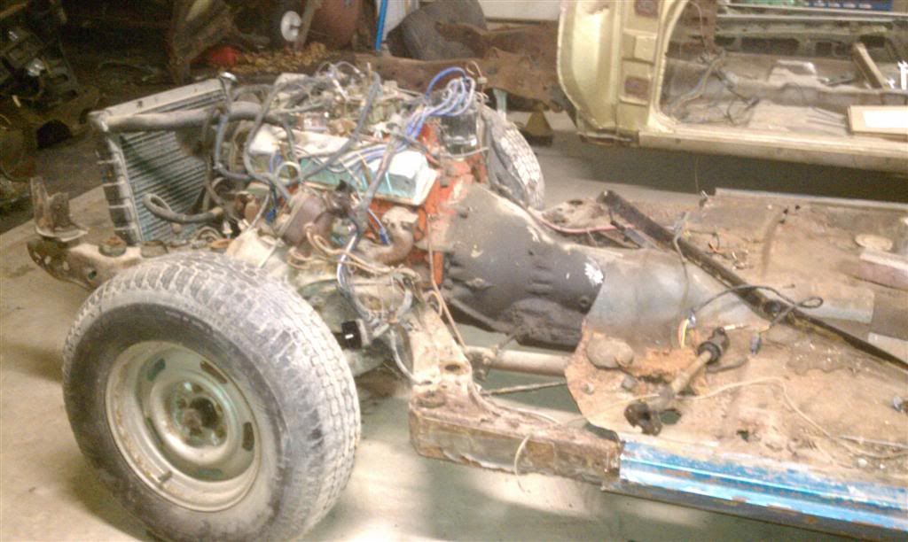

Not much progress other than than getting the donor cut up and striped down... I got it to a bare frame and I have yet to get under the car one time!!!!
