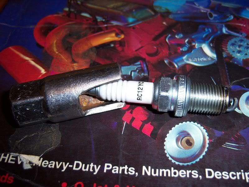

I have angle plug heads, so Sparkplug install/removal can be tough.
This modded Sparkplug socket really helps out. Cost $0.00 dollars. Old socket.
