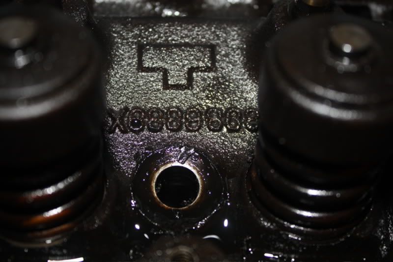

Casting number: X6889668
Those looks to be the numbers to me. Unless it is possible that those aren't 6's and they are 8's.
Any info on these heads would be much appreciated. Thanks! :beers:

Can you give us a little help, like what engine are these on or what were they on and what is the casting date?
I did just a quick check and I could not find anything based on what you posted.
1,274 Posts
You are reading it upside down 3986339X
1971 307/350 74cc
I guess it was just answered but it was a 1968 307.
1971 307/350 74cc
hahahaha, i feel dumb but a little smarter. Thanks for the info man. :thumbsup:

There is another number on the head that I was wondering if it had any signifigance. It reads: L181
Dec.18 1971 :thumbsup:
