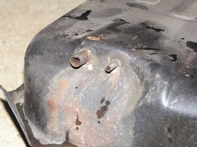

Actually, the vents are placed in an expansion chamber that should be higher than the fuel level, unless the car is down in the front.
The large vent is s short tube that ends about 2" inside the tank. The smaller tube runs at a diagonal from the right front to the left rear, to provide venting if the large vent is covered. Also notice how the large tube is crimped almost shut, to help prevent fuel from flowing out.
The hoses attach to a plastic reservoir that is mounted to the underbody higher than the fuel tank. The original design has a piece of fuel-resistant foam stuck into the upper tube to keep debris from entering the reservoir, and to soak up any fuel that tries to go out of the top. Ground Up sells this reservoir as part #XTV-689, for $39.95.
