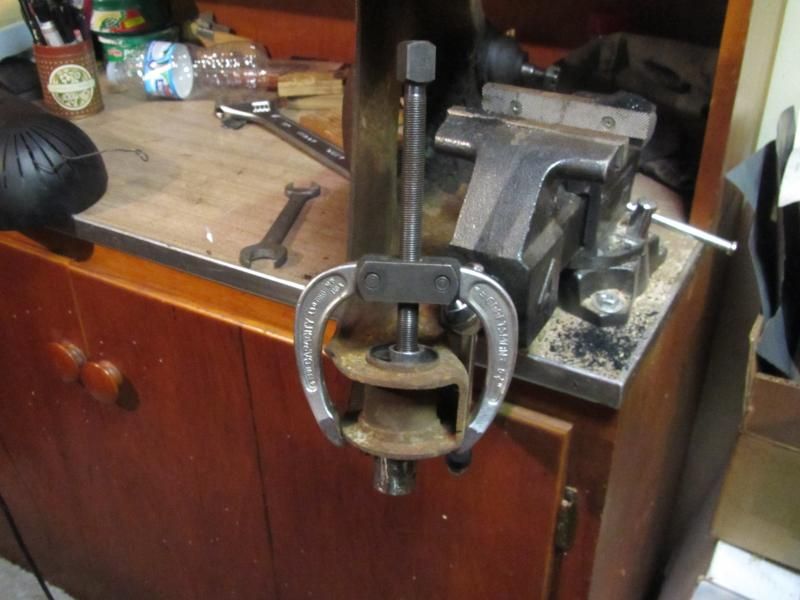

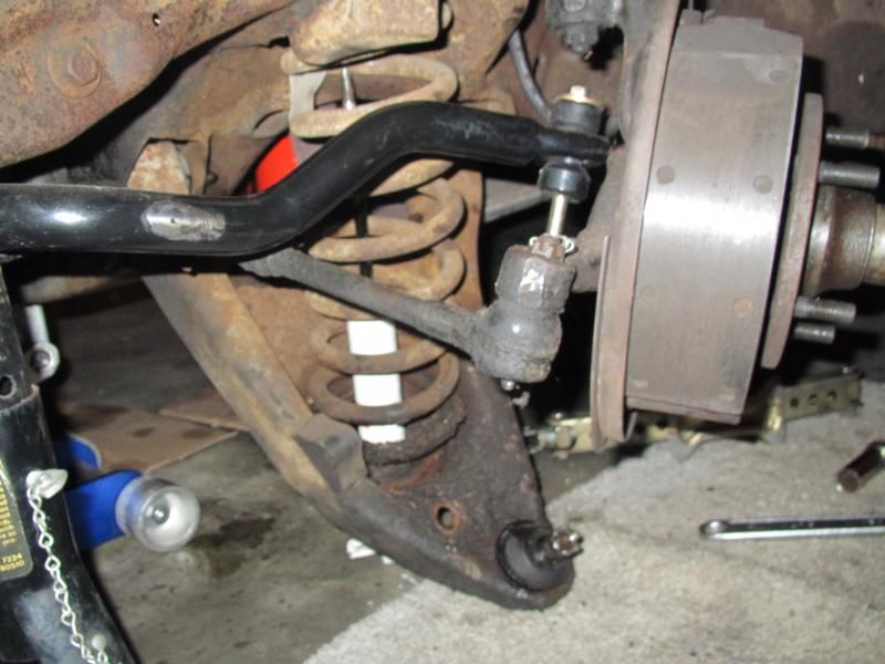

Woah!!! hold on to you seats kids cause its "way back time", necro thread if you will. I hate searching for a solution and the OP never comes back with a resolution so here I am with beer in hand :beers:. Hey it's only been a year and six'ish months :D. And don't give me grief about refinishing the arms, I thought about it and lets be honest... wouldn't pristine black arms look odd against the rusty frame?

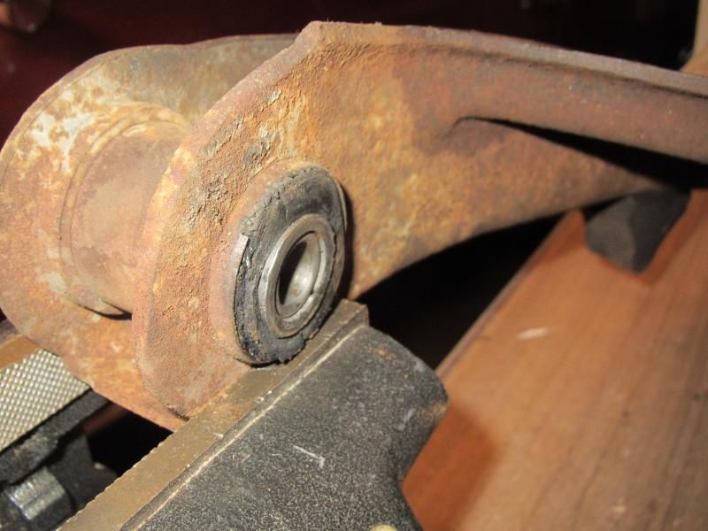

It was a good project during the holiday season with my 15 yr old son. The rubber turned out to be in really nice condition (probably why the garage guys didn't replace them!). Perhaps that aided in the removal processes, I don't know (first time newby an all...). I used a drill to remove substance from the bushing before pressing it out with a gear puller and a socket. My outside shells were in good condition so I left them in place, just cleaned them up a bit with fine sand paper. The poly slid in with little resistance using Mobil1 syn grease. When drilling the rubber be mind full to not nick the outside shell and pick your drill size appropriately. One of my bushings was thinner on one side than the other (the rubber had compressed).
So far I'd say the car is more quiet and if you will "smoother" down the road. I'm happy :yes:.
Pics or it didn't happen!
(yes, I used a big ass chain/bolt to secure the spring)
