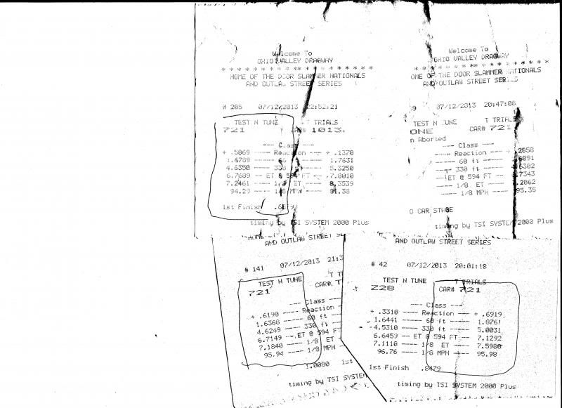

Finished installing Moser 9 with 3.70 Gears and tested the car. Best of 7.18 and 95.8 MPH
Did ok, was really wanting a 6.9 or so. Did drive it there and back without any breakage, so that was a big plus.
Car does not 60 well. Spinning and pulls the left front (what I was told) to about the 60 sensor. Feels like it hooks about a 100' foot out, just a guess. Buddy said it does not squat very well in the rear after launch. No vid's sorry.
Stall is a TCI 1800, I can hold it to about 2500. Thinking of a Coan but would like to wait for Winter.
TH400 is a TCI. Shifts strong no slippage that I can feel.
Suspension is a Edelbrock solid lowers and double adjustable uppers. Springs and shocks are stock, with no front or rear sway bar.
I have small headers, that I think are really killing me. 1 3/4 and 3" exhaust. Won't help it hook better but would make a lot more power I suspect. Lemons this winter.
Tank was 3/4 full of 93.
275/60/15 MT DR with 18 or 19 PSI with a good burnout, not John Force but good amount of smoke.
Motor is a crate 555 Musi Edelbrock, with a 1150 dominator, not the 830 that would not let it spin much past 5. Rated about 650 HP and TQ.
Question is, would 90/10 front and 50/50 rear with a rear sway bar help much? What 60' would help me break into the 6's? Also wondering with my mph is it enough to be 10's? I think 7.0 is a 10.99, looking to go a little faster.
I have made a lot of passes in a fox body stick car, so getting back to the track after 5 or 6 years felt really good.
Missed drive like a dummy on the 7.24 @94. Did not hold the lever all the way down on the pro stick.
No shift light so consistent not real easy looking down at the tach....

Jarad, anti roll bar and adjustable 3 way shocks help my car to hook better. I skipped the airbags.. More stall will help you later once you get better traction.. The car has to transfer weight to hookup..Front drag type or looser stock springs will help a lot along with 90/10 shocks, get rid of the sway bar also up front.. I went from 1.68 to 1.51 with the anti roll bar in the 60 ft..

You mentioned foot braking to 2500, is this how you launched the car?
You may try bringing it just off idle as you light the Stage bulb, then stab it on the 3rd yellow. This will flash the converter and allow the suspension to work.
When loading the suspension at the line, it causes the suspension to start doing odd things, before its necessary. Allowing the suspension to "work in real time" may lead to better short times.

Here's the problem, PAT MUSI 555 combined with 275DRs. Are ya kidding me?
first, get the car to launch, forget about more power and more converter...you'll be fighting yourself forever!
short list on whatya need right away:
Quality front springs
4-way adj shocks
rear anti-roll bar

Honestly, you need the correct converter for the car. I wouldn't spend a penny on any of the other stuff till you get the converter and see where you are.
Also, save money for a double adjustable shock in the rear. Just use stockers till you get to the point that you can get the doubles. Plus you are using a radial tire, a double adj in the rear will help far more. Adjustments need to be made independently. Compression will be maxxed out and you'll need to adjust extension to control the apply of the "hit".
A car should not squat at lauch, it should seperate the body from the tire. When you see that, you have geometry planting the tire.
Do not cheap out on the converter, Coan is a good company, buy what they recomend and then run the car again.
Just completely eliminate 90-10/70-30/50-50 from your vocabulary, it's old tech and in my opinion a total waste of money. You can get the same results with Autozone stock replacement shocks, to a point.
