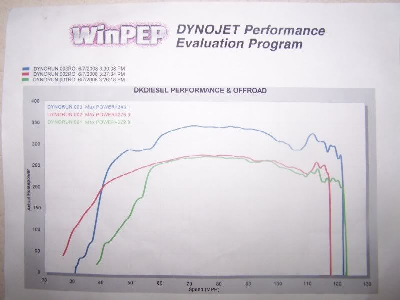

I have been having issues with my new motor not pulling well beyond 5000 rpm. It hit 5000 and just hangs there. Then after a couple of seconds it will slowly wind up to 6000 where I shut it down.
Today I put it on the dyno and could only get partial info. The operator said that the torque numbers were registering intermittantly, possibly due to my not having a ground strap:eek:.
Here's what I got, I know it's not much. Notice how the first 2 runs on motor and the 3rd run where I hit it with a 125 shot on a cold 700lbs of bottle pressure look almost identical in the shape of the graph. The A/F was in the low 12's throughout the testing. Fuel was about 98 octane (pump 92+2oz kemco per gallon).

I don't know much about N2o but you could be getting into valve float. I don't know what AFR N2o likes but I try to stay around 11.2~ 11.5:1 with my turbo's. A week ignition, and or plug gap too wide can also act that way, but like valve float you should go rich. What's your exhaust system like? 2.5'' pipe should be large enough, but if you have some $hitty mufflers, or tail pipes that could choke your top end too.

I have 2.5 duals with short Magnaflows exiting under the bumper.
Ignition is an HEI with Accel coil/cap/rotor/wires/short header plugs at .045.
I am running a stock module though.
The flattening at 5000rpm was the same on motor as it was on nitrous.
Mixture stayed the same on and off the bottle too.

the chart looks something like mine except you put down more power and more torque with a smaller cam.something isnt right with either of our motors lunati will be getting a call tomorrow from me.if i find something out i will let you know

let's see, nice 355 with Harold cam, 5/16" fuel line, hangs at 5K. What's wrong with this picture? I wouldn't spend any money or time on other stuff til you get this glaring 5/16 deal fixed.
I think you're lucky you still have 8 pistons. Got any tiny black specks on the spark plug porcelains? Didn't that dyno guy have a wideband O2 setup? You can get one for $300, cheaper than a carb or some high zoot ignition deal. After you get your stuff straightened out you can sell it for $250 easy.

change out that fuel line, regardless of what that a/f says. 5/16 is no good. im going through the same BS with my car. the dyno operator stopped after one 4000 rpm pull.
and like itold matt before, throw the same springs on that i have in my motor with a voodoo 60104. they are the 74818LUN beehives. 168 bucks on ebay with free shipping.

He had the A/F with positive results. I agree that he's living on borrowed time with the small supply line, but the A/F doesn't lie. How long did this test take? Other than the nitrous run, I don't know how much the fuel system even matters on a short full throttle blast on a chassis dyno. Doing the same nitrous run on the quarter mile could potentially have him scraping piston chunks off his spark plugs.
The fact that the 3 curves look suprizingly similar holds the clue IMHO. If it was an ignition issue it should have showed up earlier in the RPM due to increased cylinder pressure which increases ignition demand. Regardless, a better module is a wise investment, once he gets the engine running properly it will need a more reliable ignition. (spins it to 6000+)
The fact that his and the other "dyno woes" thread are pretty much a zerox of each other in terms of shape and power fluctutation at roughly 5000 lead me to believe they have similar valvetrain control issues. An interesting (and time consuming) test would have been to shim the springs up .060" or so and made another pull. It could be harmonic related, but likely lifter and/or spring pressure related.

Find out what you have for seat and open pressure please.
My springs are Crane 99893 set at 1.875 @ 120.
Crane says.. 1.460'' diameter double spring. Valve lift up to .690''. 120# @ 1.875'' closed, 426# @ 1.110'' open, coil bind @ 1.080''.
We are going to try shimming them .060 and see if that changes anything.
My friend that assembled the heads was in attendance at the dyno pull and he mentioned we might try shimming them .060.
When I posted looking for help on here, Doug "rustbucket" said that it would be interesting to see what would have happened if we had done that as well.
All it will cost is time to try it. If it doesn't work or at least move the problem up the rpm scale then I think I can look at other stuff.

ASSUMING......You have the pushrods/rockers/valvetrain etc. that are capable of the added spring pressure, I would consider even .090" less installed height.
WAIT! Brain was thinking you have a hyd roller, you have a flat tappet. Installing those springs at 1.815 (.060" shimmed) will put you at 143# seated, 348 open using Crane's specs. That's a little stout for a hyd flat tappet cam. I'm not saying it wouldn't work, but I would be calling Lunati before attempting these pressures. Of course, what the book lists for pressures and reality rarely match, but I would be tempted to try 135/325 which should be a .030" shim. (again, relying on everying being as per specification currently) This is where you need to take your time and measure all your installed heights and measure your current and open pressures.
