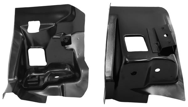

I am interested in finding out if anyone has used Dynacorn (DII) GTO firewall brackets for rebuilding a Chevelle convertible? I will post pics and p/n's of what I am talking about; the pics are from DII's site. If there is an issue with these pics this way, please delete them.
The firewall brackets for a 68-72 Chevelle (non-vert) are pn 1461F:
These match the brackets seen on the 68-72 Chevelle (non-vert) firewall assy pn 1461B:
The firewall brackets for a 68-69 (thru 72 according to DII tech) GTO are pn 1506F:
These appear to match the brackets seen on the 68-72 Chevelle convertible firewall assy pn 1461H:
According to the Dynacorn tech, the GTO 1506F brackets WILL NOT FIT for use on a Chevelle to replace the firewall brackets for an upgrade. However they sure look like brackets I have seen on Verts (and Montes) the get the extra bushings at the firewall. Am I missing something here? Did GTO’s get different firewalls from other A-bodies? Or will the 1506F brackets fit a standard Chevelle firewall and I can use them to get the extra bushings on my car?

I just purchased the same pair for my GTO, I'm not sure about if they will work for you but I attached photo's of my '68 GTO L & R mounts, perhaps you can compare with your firewall? I hope it helps
check OPGI firewall body mounts 68-72 chevelle. the pair price is reasonable. they will work on a coupe for the extra body mount. i dont know if the GTO piece will fit a chevelle. the extra body mount, at torque box, i associate with convertible, el camino, high performance, and station wagon.

Looks like OPGI has the same stuff, shows the 1461F style for Chevelle and the 1509F for GTO (I mis-wrote 1506F above). My Elco and Concours wagon don't have these, but my Montes do (and verts as you have mentioned). Never have seen them on a coupe or 4 door, regardless of motor, but did see them on a standard (non GTO) Lemans. Want to install these on my wagon as long as it is torn down anyway.

I went ahead and bought the GTO brackets, they <look> exactly like the brackets on all of my Montes (70, 71, 72) as well as looking like the brackets attached to the Chevelle convertible firewall assembly for sale by Dynacorn. Looks like a duck, walks and sounds like a duck, may be a duck!
I am getting closer to the actual install of these on my Chevelle wagon, so in a couple of weeks will have realtime fitment feedback. But if DII really copied genuine 68-72 GTO parts, and GM for some reason made these firewall brackets and the mating firewall of a GTO different from all other 68-72 A-bodies, I will be very surprised. But I will make them work.

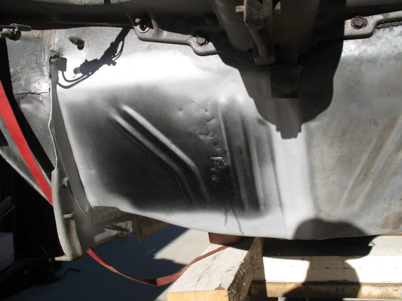

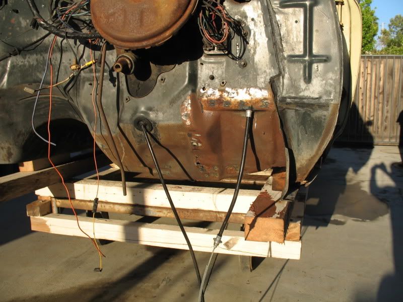

Finally my project reached a point where I could deal with the brackets. I was kinda dreading this cuz it's a ba11 buster, and is kinda irrevocable. Screw this up and I'm done. Or at least more miserable...
Removed the original single bushing brackets, man what a lot of work coring spot welds in that thick metal. Finally got them both off.
Check fit of the repros, fit looks very acceptable, I pushed them both in as far as I could to achieve best fit and contact. Little mismatch on pass side at top, but I have total contact all around, so should be good to go.
Blasted off the rust:
Interesting note, the firewall was painted completely down to the floor on the pass side, but the drivers side had a line of no paint following down from the bracket (and speedo cable outlet) into the tunnel. And the firewall was painted a metallic blue-green from the factory. Pics don't show it well, but it isn't black,
Need to fix some operator induced damage (drill-throughs, etc), and prime with weld thru primer, and then I can install the new firewall brackets. I will update as I weld them on and then attach the body onto the frame, which will show how badly I have screwed up!

have a single mount pair i removed from a 72 El Camino firewall / cowl section. Drilled out spot welds from inside the firewall, as opposed to your drilling from outside. Can see why it was such a PITA. Metal probably was three times as thick as the toeboard. would imagine the dyancorn ones arent as a thick guage as original GM. Removing from the inside, wasn't too bad, in my opinion, but it left a line of holes in the lower firewall toeboard. Wasn't saving that section, so that's why i did it that way.
1509F is the GTO part which I believe will fit 68-69 chevelle convertible. (you want this)
for reference look at pics of 1509F with 2 bushing locations
http://www.dynacorndepot.com/GTOdetail.aspx?ID=10854
1461F is the chevelle piece with only 1 bushing mounting point. This will not be ok for convertible. (you don't want this)
for reference look at pics of 1461F with only 1 bushing location
http://www.dynacorndepot.com/ElCaminodetail.aspx?ID=9223
Hi Gabe
Joe is correct, for a convertible (vert), you want the 1509F/GTO firewall mounts, these are what I bought and installed. These look identical to the ones I am used to seeing on a Monte Carlo (first place I saw them) and fit up to the car really nicely. I do not know why Dynacorn doesn't or won't sell them as parts for a Chevelle convertible, Monte carlo, or (as I have learned since starting this) Buick Skylark, which has 4 bushigs along the firewall as well. Some of the local resto parts places didn't want to sell them to me as they couldn't guarantee these would fit my application, untried territory and all that. I purchased mine from a local Pontiac resto parts shop here in Southern California. He didn't care what I was doing, thought it was a neat project. I would imagine any Dynacorn reseller could get them for you.
