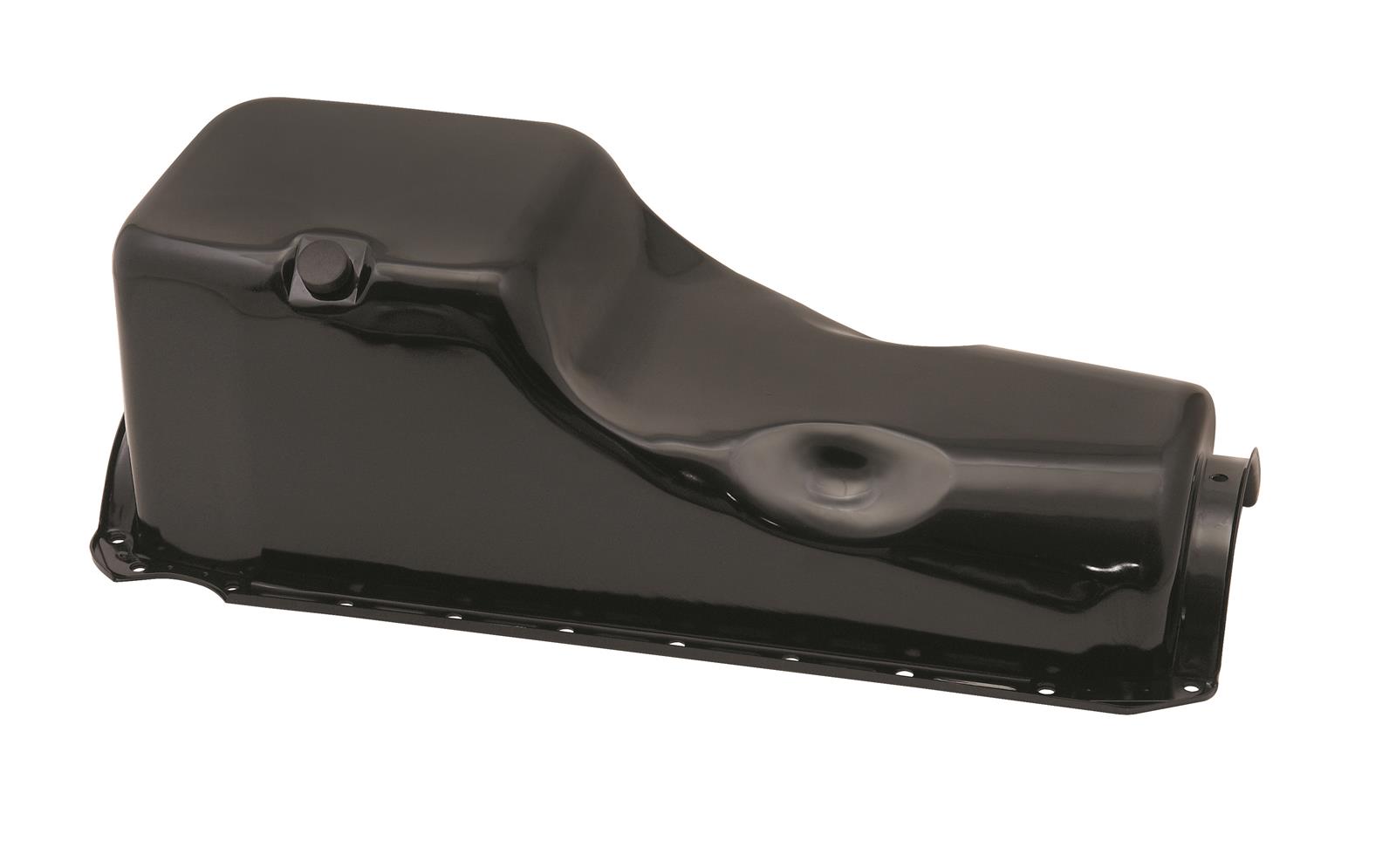

For a small block, I believe it's not dimpled, but just not squared off so it has the impressions moving inwards towards the front.
For a big block, I think it actually has dimples.
I did a quick search at Summit (and not commenting on the quality of any of the below, just the shape) and I believe these are the right fit pans:
Small block:
Big Block:
BTW - here is an example of a small block pan that is squared off and will most likely hit the steering. It is unfortunate they say this will work, as it most likely will not.
Small block:
Big Block:

The engine builder suggested a Moroso 20212 pan which will fit the front and is made for a 1 piece rear seal however it hangs 1" lower than my crossmember as it's a 6 quart pan as opposed to the 4 quart pan I have now. I'm having the pan modified with small dimples towrds the front to make room for the centerlink-tie rod area. Now I just need to find the right size fitting plugs to put the zerk spot to make more room. I intend to just remove plug and replace with zerk annually on maintenance..
