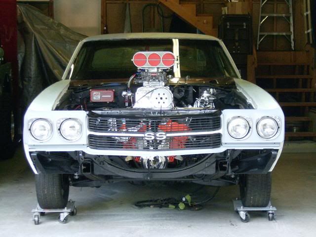

I finally got the motor back in the car and everything else mostly mocked up, also went ahead and installed a new stainless tank and fuel lines along with setting up the Holley electric fuel pump.
I also wanted to run a different blower scoop than most people have, so after searching around for a long while (and saving up ALOT of pennys ) I contacted Alan at "Garlits Performance Products" over the pond in Auckland New Zealand, and told him exactly what I wanted my bug catcher to look like, and he then custom built me this stunning polished scoop. The blower is a simple Weiand 6-71. ( I still have to get another set of new blower referenced carbs..)
Here is everything mocked back up in the car... ( picture dosen't show them, but I've already installed the correct blower snout pulley spacer and idler pulley setup, to correct the belt spacing issue from switching the supercharger from a small block to its new big block home).
Still got a LONG ways to go, but I'm at least happy to see it at this stage..!! More to come soon.
