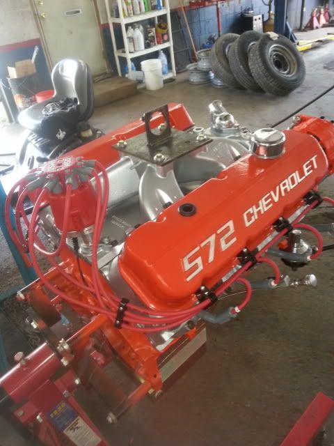

Here are some pics of my new Taylor wires installed.(74004) 45deg. angled plugs. they all clear the headers fine. Hopefully this helps someone else who is looking for the right spark plug wires.

Heres pics of my Taylor 76032 wires with 45/135 degree boots at the plug I like the gm 12495502 wire looms good looking, discrete and cheap without sacrifice function.
