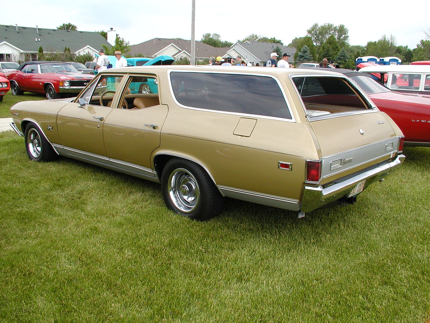

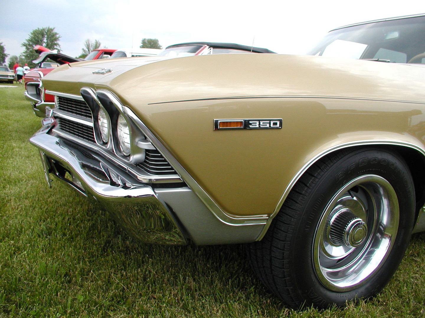

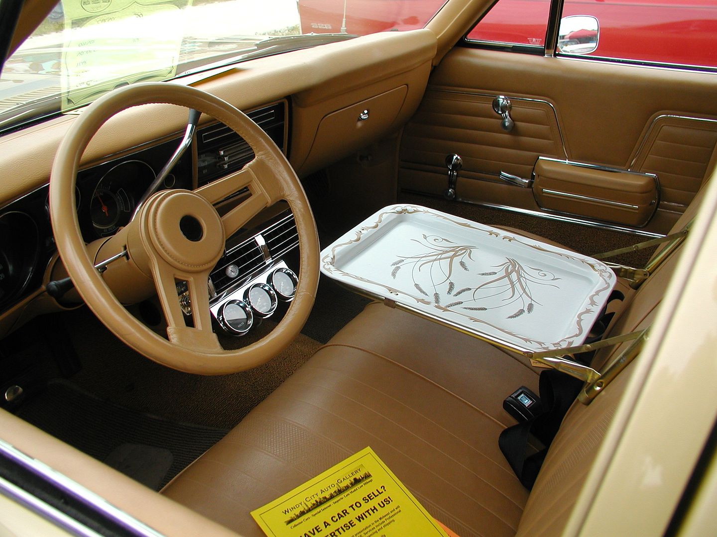

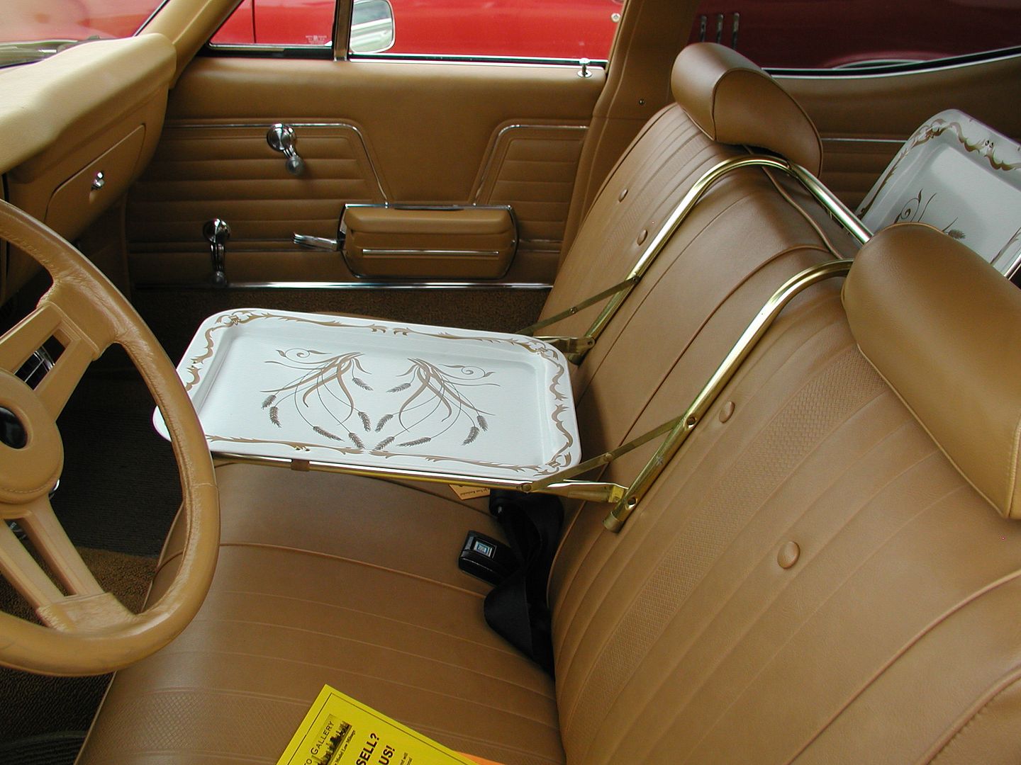

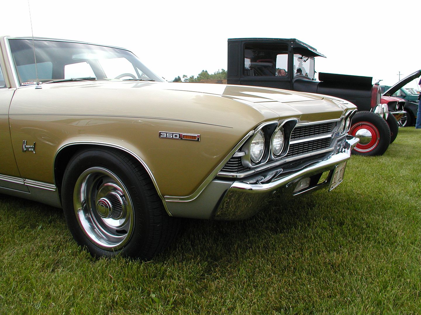

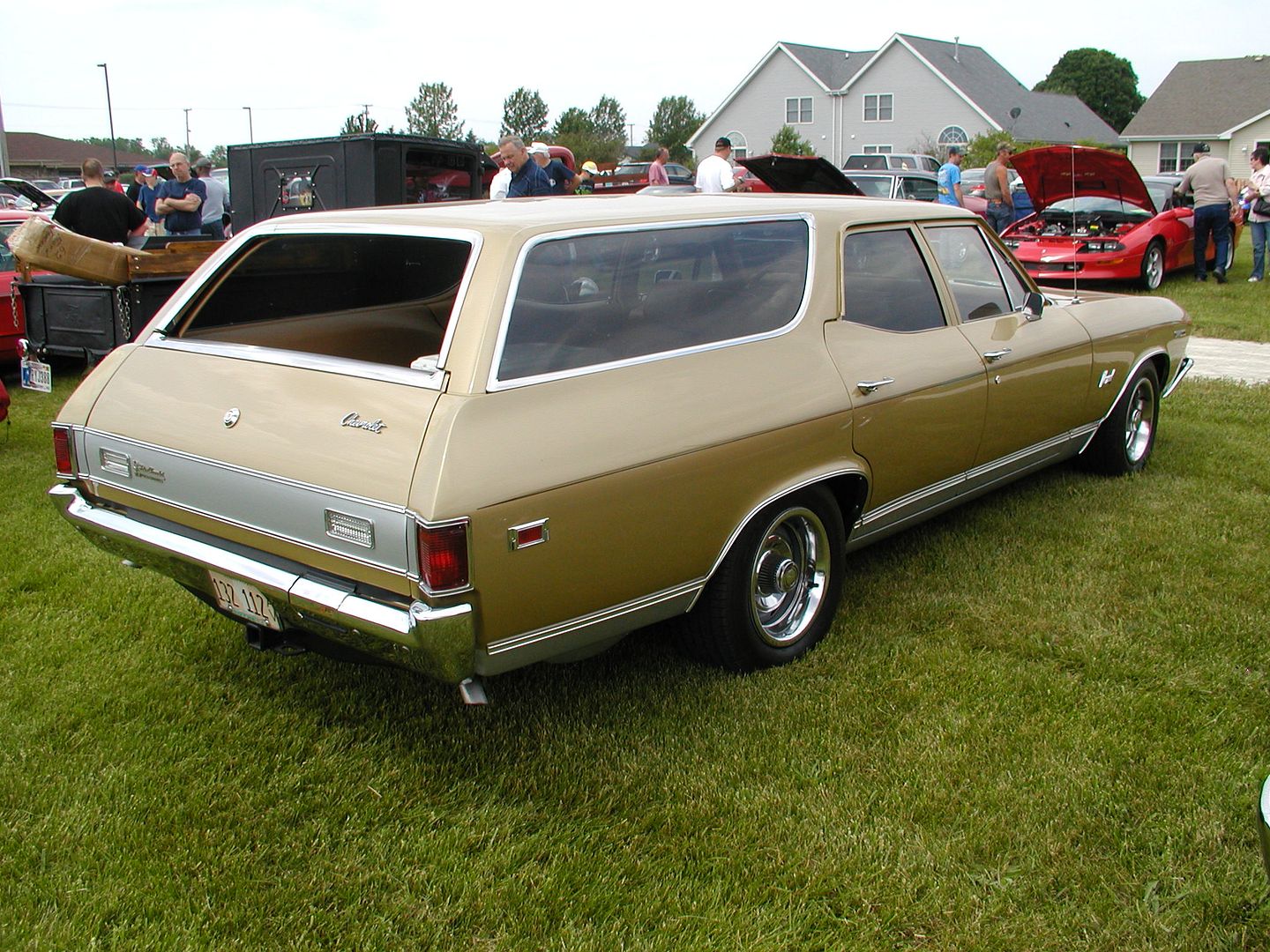

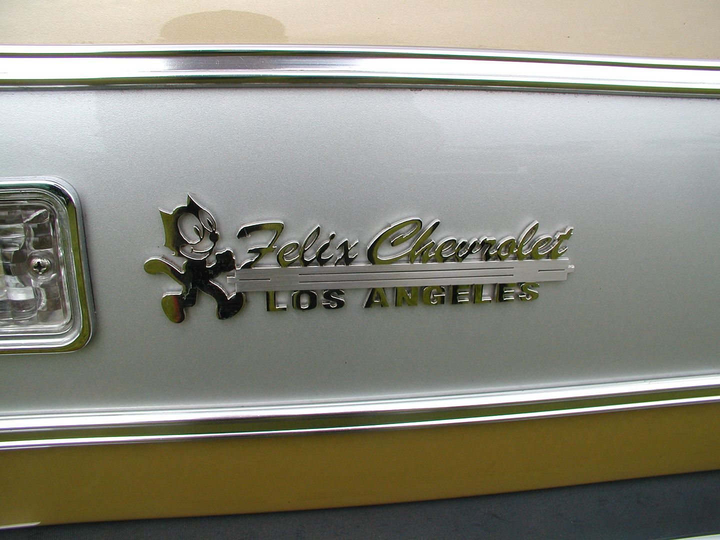

2,028 Posts
Cybrslider (can I have a real name to call you by) and Dan,
Here is a little something to insire you both....
Dan you`re a good man to built your wife a wagon.....see you at NOCC.
Dan
Reactions: LeoP
