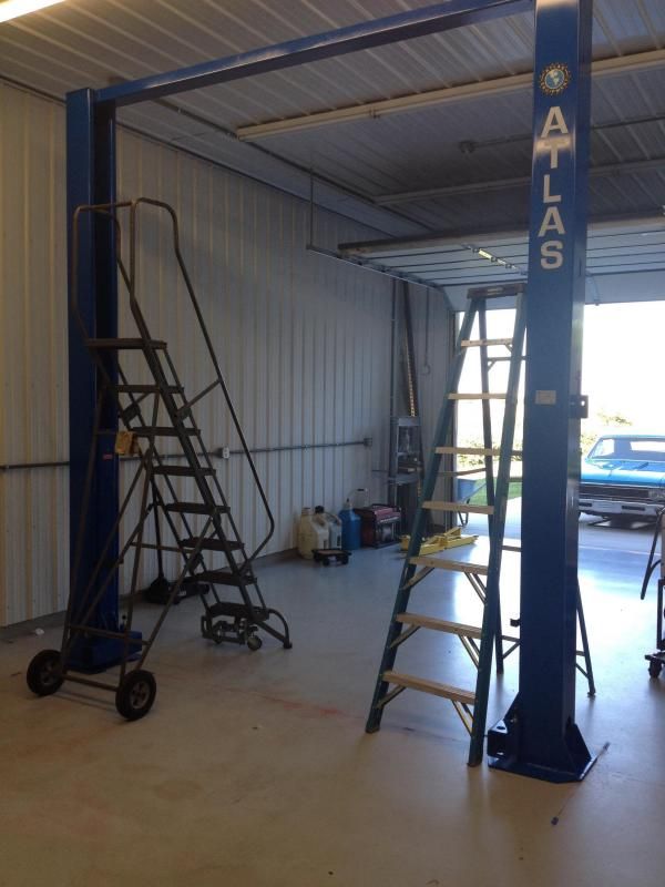

Sunday I finally got a chance to install my new lift. This is something I have wanted for years but never quite got around to getting. It's going to make life so much easier. Only thing I have left to do is drill for the floor anchors and I'm sweating it because I have radiant floor heat.
I spent hours the day before we poured the floor, measuring and taking pictures. I knew exactly where I wanted to put a lift in the future and laid out the pex tubing accordingly. I will probably not have any issues but I'm still freaking out a little. Wish me luck, it will get drilled tonight.
I finished the shop 2 years ago, I don't know why it has taken me so long to get the lift. Every time I'm bench pressing a transmission from my back, I cuss a little and say I'm ordering a lift tomorrow:) I finally kept my word
Yeah a lift is a awesome helping hand

Atlas lift- that's what I have. I've had mine for 4 years with no issues!
