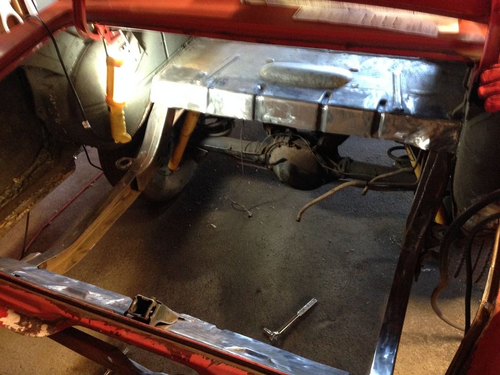

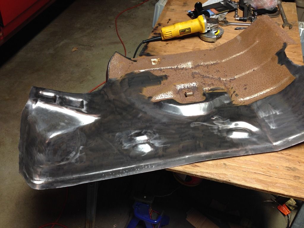

Looks like someone did some work on this back in '84. Found these in the driver side trunk.
Borrowed welder from a friend...time to try my hand at welding!

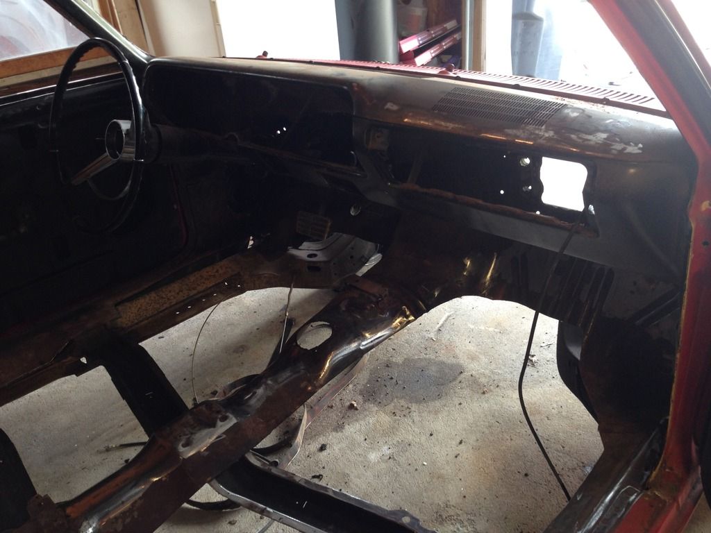

I have to say that the windows have been one of my biggest worries. I tried to take many pictures but they still scare me when I get to putting them back in. This was the back passenger side one. You can see that the bottom piece is broken off the frame. I don't think I did that when removing it, but it is possible. Finding a replacement for that has proved very difficult.

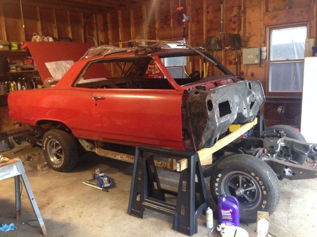

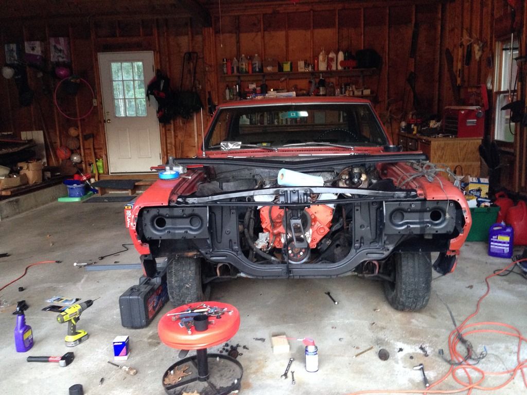

And then I decided that I needed to clean up the frame and body mount area. So turned into a frame off. Complete ******* job on this also, 1 person, back and forth from one end to the other. I will be amazed it it ever fits right on the frame again.
And the two pieces are finally separated:

Wow where did you get all that energy Dan?! What a great start, I'm jeolous. I guess I don't need to feel too bad, you waited 15 years to get at it,, I'm at 8 years and counting! LOL,, mine has been a driver all along but still needs a frame off.
Boy someone really whacked that passenger side front! Like a box of chocolates man, ya never know what you'll find when you bite into these old rides. How was your frame horns? How did it get so much of an impact there and not cause the cowl to buckle? Guess you got lucky.

yankee- The horns look okay, there are definitely some change marks where it was stretched and straightened at some point. Also the back area behind the rear wheels is stamped with a different vin. So I am guessing it had a tough life long before me. I see yellow paint, I see maroon paint, and I see the red that it is now.

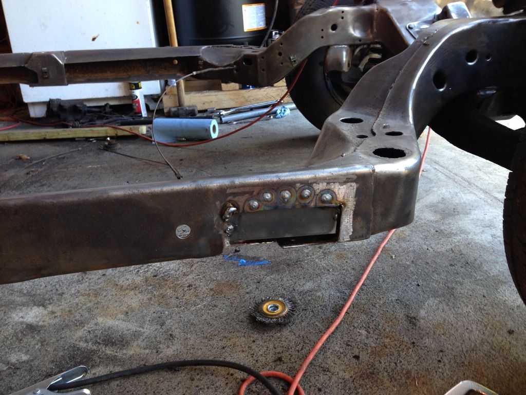

Here was some frame rot which I needed to take care of. It was in the same place on both sides of the car. Right below the front of the doors.
And through the repairs...
Driver side-
