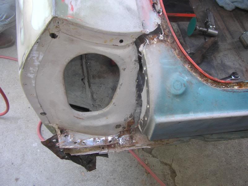

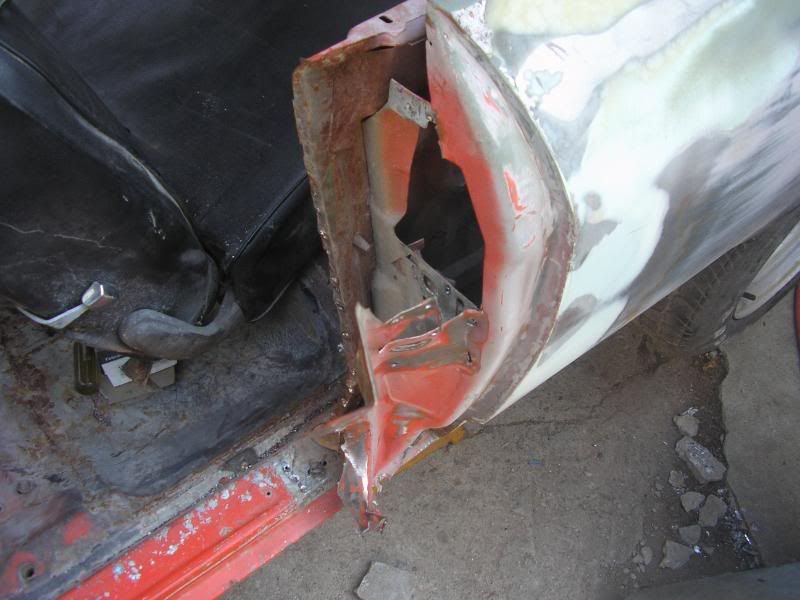

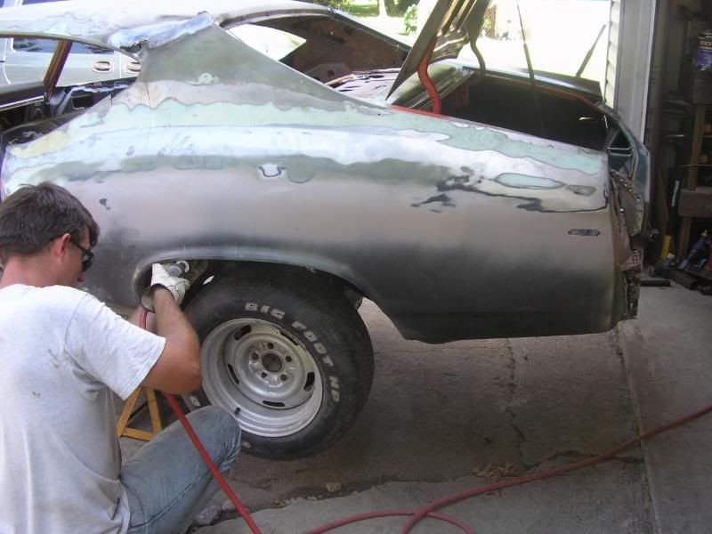

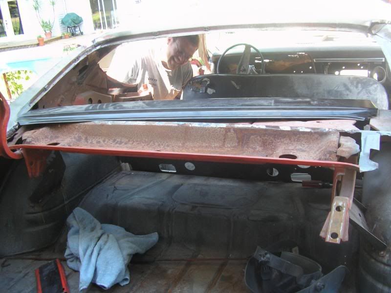

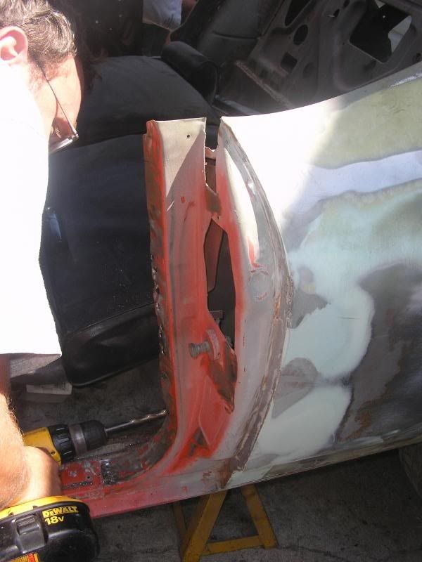

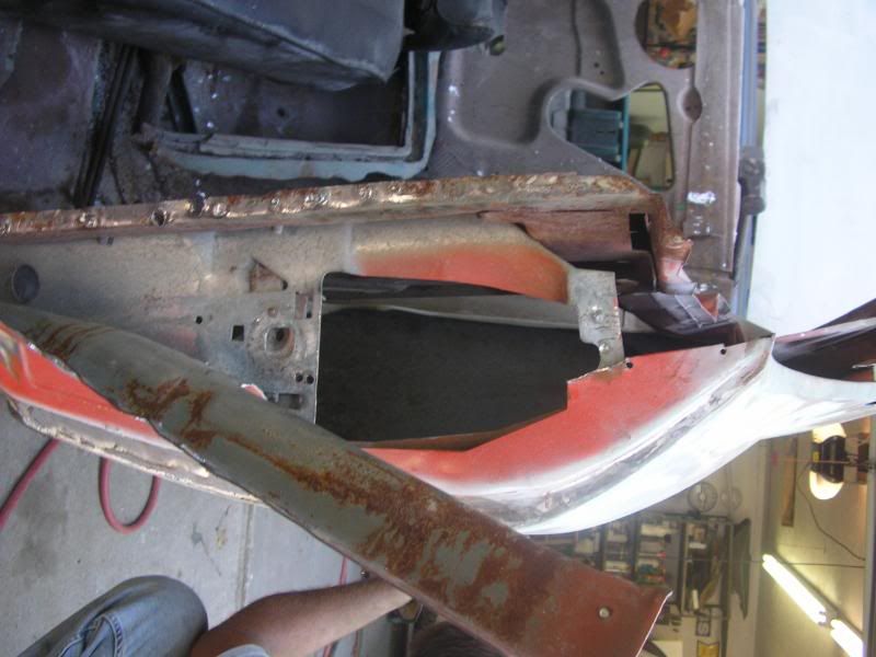

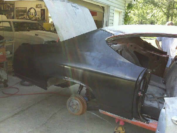

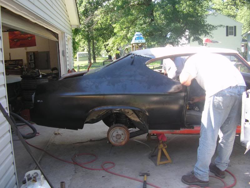

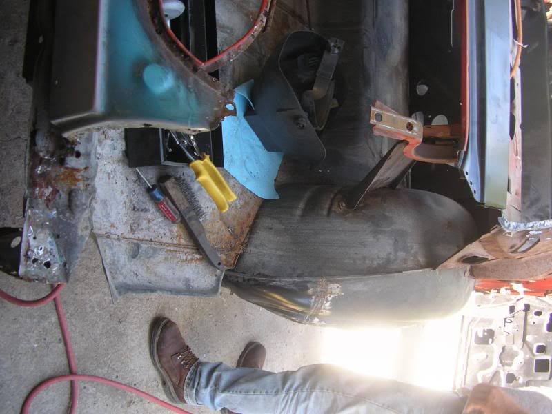

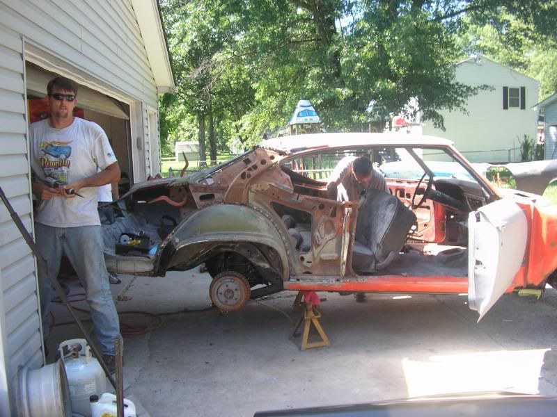

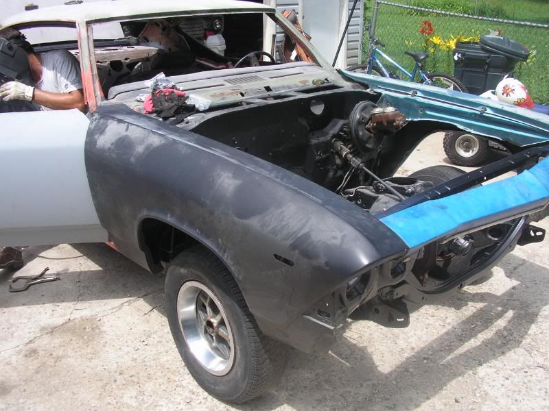

Bowtie70SS and I went absolutely bananas on my 69 over the weekend. Dave is the MAN! We removed the hack job skins that were put on the car by a "reputable" body man who does high end cars like Yenkos, COPOs, Motions, etc. (PM me for details) We did full aftermarket GM quarters and a filler panel. The car turned out fan-damn-tastic. I'll let Dave chime in later with his .02.
Anyhow, here are the pictures we took. Please wait until I load all of the picutes before you make any comments so that I can keep all of the pictures together.

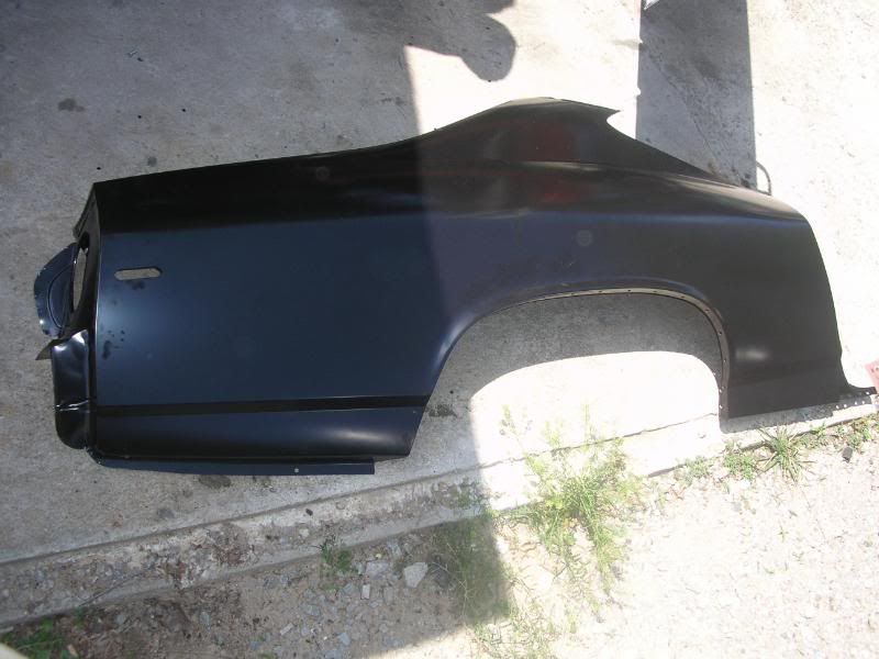

Nice. - What brand 1/4's did you use and how did they fit?
LK
I used whatever Restoration World in Huber Heights, Ohio carries. The quarter panels more or less fell onto the car. A little trimming here and there was needed because every car is different, but they really fit well.

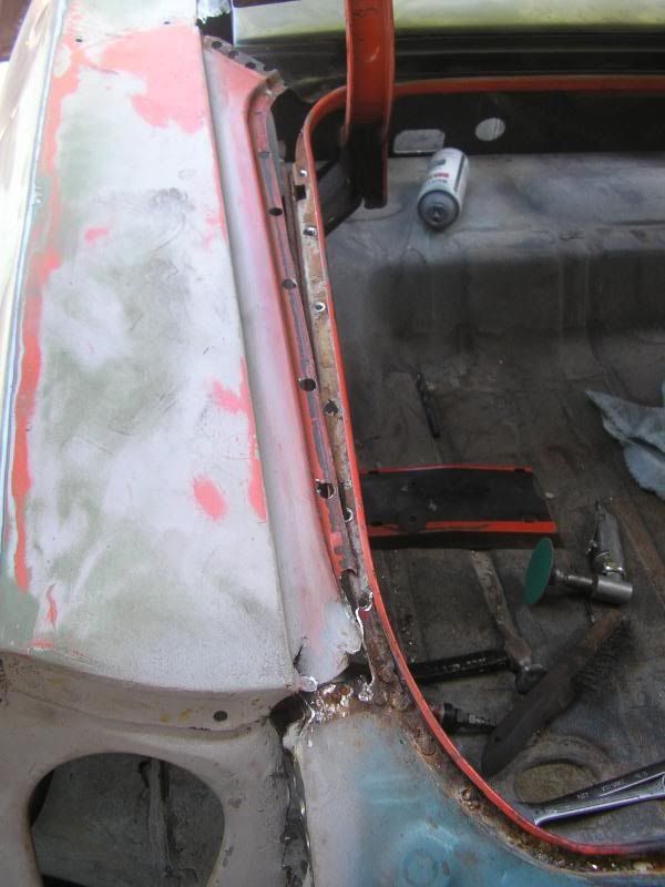

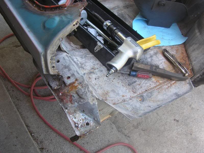

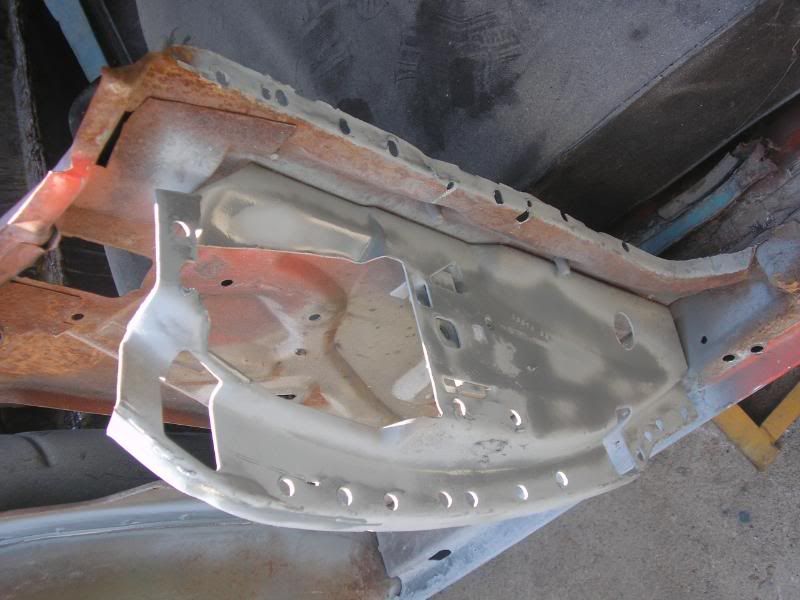

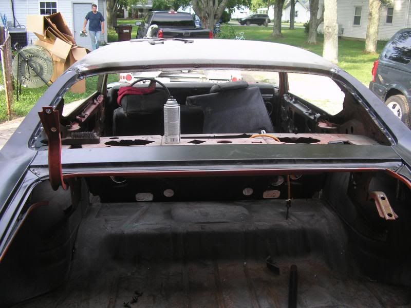

What did the air chisels help you do? Also, I have a hard time finding the old pinch welds, any tips on finding and drilling them out the way you did?

Dave was the brains of the operation. He did the welding. I just provided a strong back and something to curse at. Just get at it. It's not so bad once you get going. There's all sorts of spot welds that are hidden.
Take a wire brush and get the old paint off of there to reveal the low spots. Then drill out the spot welds. First with a small bit, and then a larger bit, and then hit it with the air chisel. We also used a tool that was called the "Panel Buster". It was an "L" shaped piece of iron that was sharp. You put it inbetween the sheet metal and knock the spot welds loose with it. Dave made the air chisling look like a cake walk. We did have to sharpen the chisle bits on a bench grinder to make sure they were good and sharp. It sure does make quick work of spot welds.
