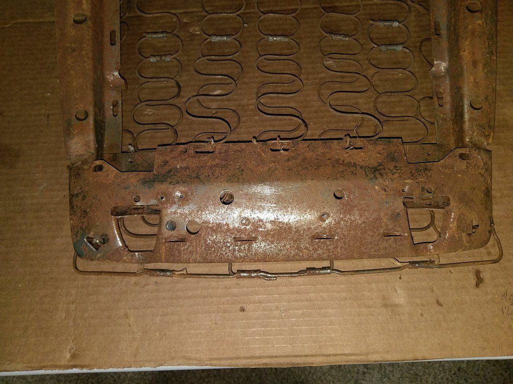

Naked seat back

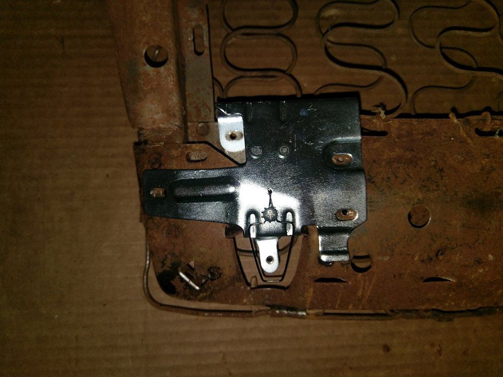

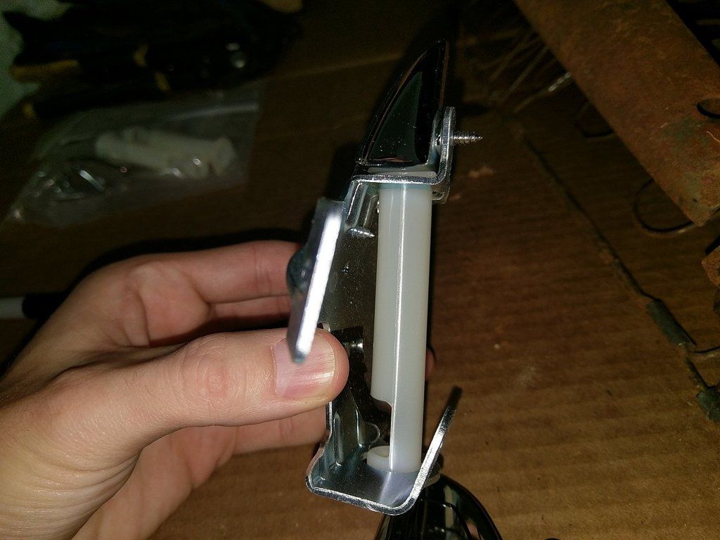

Side view of the brackets, they screw onto the backs, then you slide the plastic tube through seat back and bracket.
You must adjust (bend) the brackets to make them hug the seat back. This is easiest if the seat cover is not on the back.
Top view with plastic bushing:

Once you get them both mounted, check the distance between them by inserting the headrest. This will save you a headache later when you are mounting the brackets with the seat cover on....
Side view showing just how they attach:
It also important to note that these brackets REPLACE the tabs that hold the seat back on. So test fit that as well.

Screw on the left is a kit screw, right is what I purchased. The holes in the backs of these buckets were hogged out so I needed #8 x 3/4" for all holes on the seat back. The lower one could still use the shorty.
