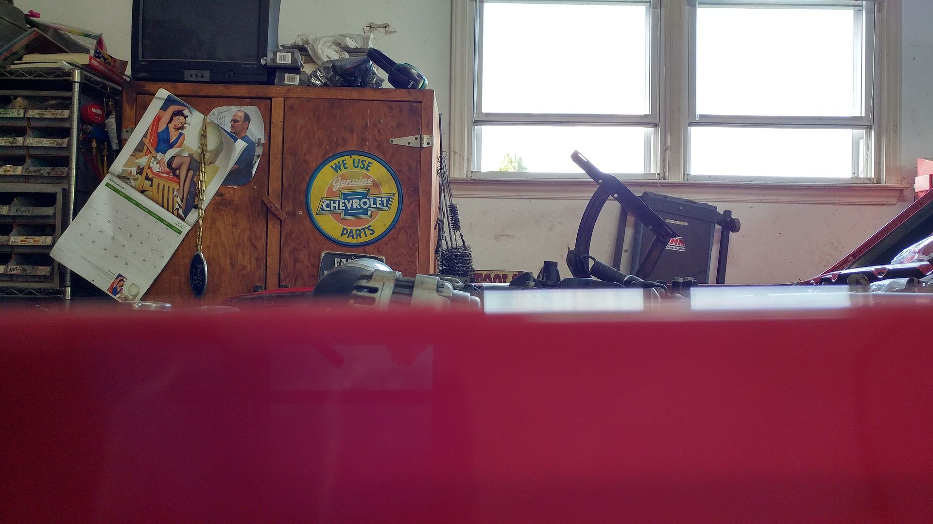

You have to keep in mind the 64/65 chevelles have a very flat hood, not sure if there's the same amount of height between crossmember/tierods and hood bottom as there is in a camaro??
I know this isn't the best shot, but you can see alternator, throttle body, and top of truck intake above the fender lip on my 64. This is with f-body pan and ~2.5 finger widths between inner tie rod and bottom of oil pan. (I know, really scientific..)
