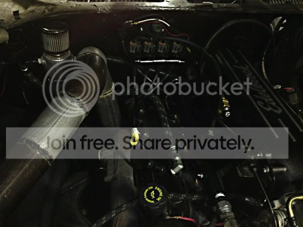

Still working on the engine bay. Just trying to make the compartment as clean and efficient as I can. Today I managed to make a bracket to mount my coil packs together and mount them to the fire wall. I purchased some 6" threaded rod 1/4", some nylon lock nuts, and some steel spacers that I slid over the rod to keep the coils at a good and stable angle.. I also got some tabs to mount the rods to. All of this was found at Lowes. For spark plug wires, I purchased a set of stock wires for a 1998 Chevy Truck with a 350. They were a perfect fit at the stock length.
There is probably a better place to mount these but it was simple to run the wires and never touch the manifolds or down pipes. It was also the best place for me so I could still connect the sensor from the pcm to the coil packs. Only got one side done but I think it turned out pretty good. I like being able to see the valve cover without the coil packs on there much better.
