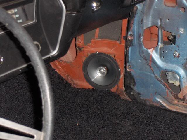

The smugglers box can be done, but does not usually offer good sound and is usually hard to seal from the elements.
I mounted two in the dash under pad since, but some models only came with provision for one speaker in the center. Plus one in each door. Six speakers under the shelf below the back window. Two 10" speakers in truck boxes. Two amps, one running the two 10s, while the other ran the rest. Has been more than enough so far.
The kick panels also offer a good spot. Some have also build center consoles with locations.

Some pics would be great & were do you all get the kickpanels for the elco.

What gen do you have? I can post a pic of a third if that is what you have. OPGI and others have the kick-panels, may just be for a third gen.

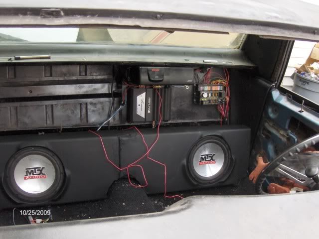

Very nice setup here is what we have going on in our 70 El Camino custom made box housing two 10" subs. We cut the kick panel metal to hold a 6.5" speaker and once the kick panel is put in place you dont know there is a speaker there. In the first picture with the sub box and can see our amp and a cd changer.
