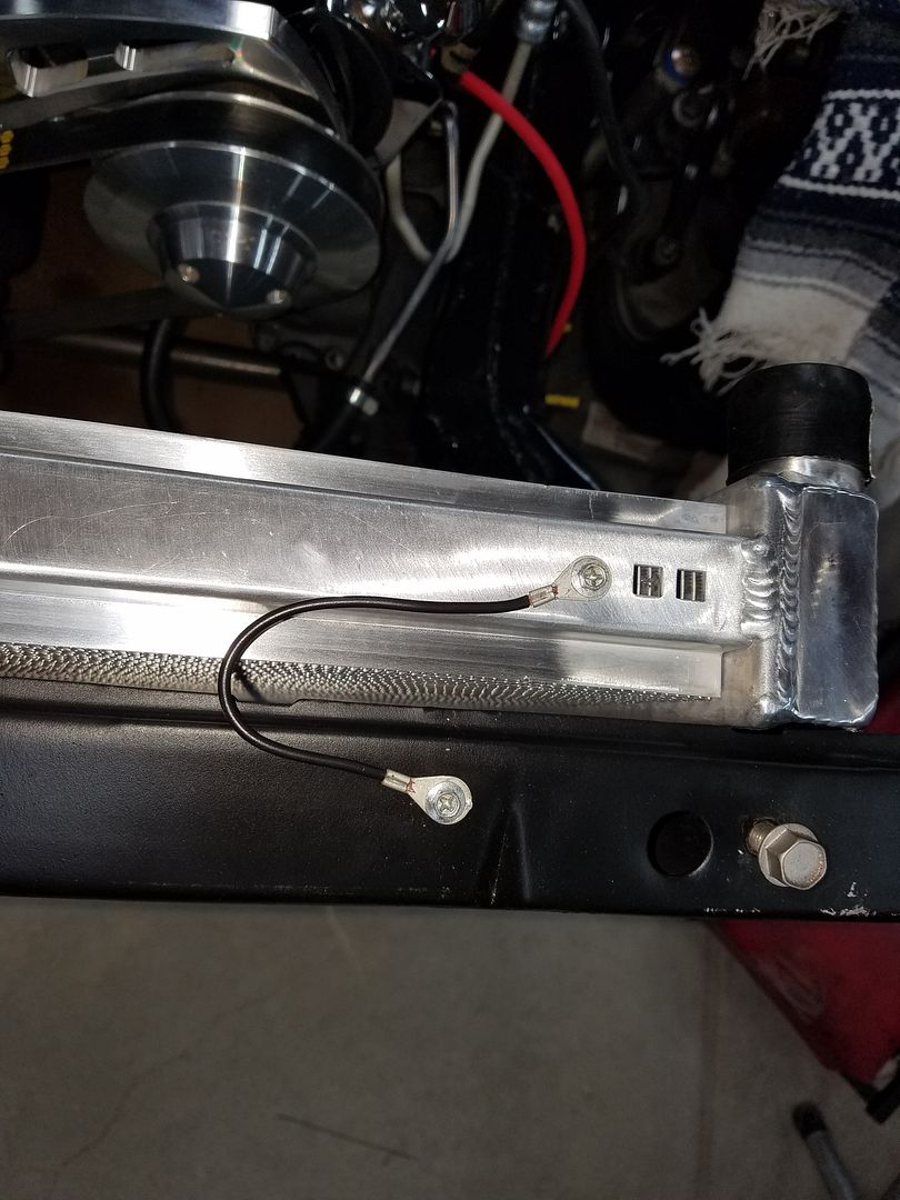

Aluminum radiators. Anode and ground straps.
My first aluminum radiator I bought came with wire with eyelets on both sides and no inztructions. Did some research a d it's recommended to ground the radiator to the core support even though it's ground thru the antifreeze. No sweat I went and attached the so wire.
I also read where a sacrificial anode is a good idea because of the dissimilar metals. Another cheap insurance. I installed it where the drain pet cock would go.
I've done this to my Last three cars with aluminum radiators.
Anyone else doing this? Anyone not thought of this? Overkill? Jim

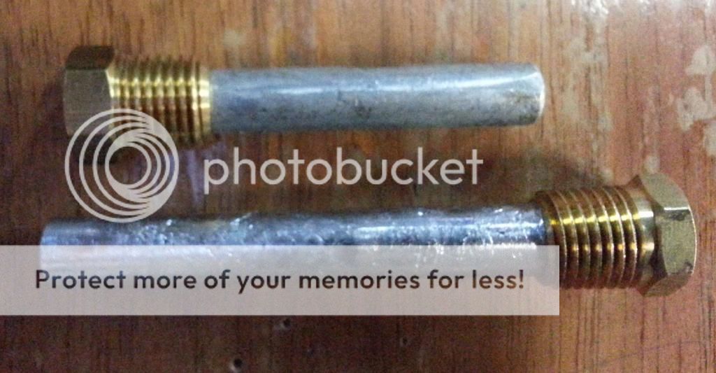

I use one in the radiator and a couple in the block where the drain plugs are.
Don't buy them from the bigger parts houses, as you won't get much for your coin. I buy mine direct from Rotometals.com.
Compare the 2 below, the one from Summit is $5.71 dearer than the Rotometal, but the Rotometal item is substantially larger than the Summit one. Picture below.
There may be cheaper places for you guys to buy, but it's more limited for me in OZ.
https://www.rotometals.com/flex-a-li...c-anode-32060/
https://www.summitracing.com/int/parts/flx-32060
