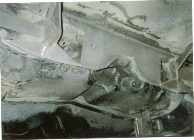

What year is your Chevelle? (that's assuming that you're talking about a Chevelle ofcourse)....here are some pics of my BMR bar frame brackets in my 70 Chevelle. On one of the bolt on each side I had to cut a flat side on the outer portion of the washers since I was using big diameter washers, and I needed to place the bolt hole very close to the webbing of wall in that area of the frame crossmember.
Just so you have a better understanding of the areas that you'll be seeing in the pics I'm showing you, here's one showing what I did to the rear crossmember to strenghten it. Notice the webbing gussets that I made and then had welded into those areas at the bottom of the crossmemebr where the rear lip at the bottom meets the mounting ears for the upper control arms. One of the two reasons I did this in thse aeras is because I knew that i would be using one of these bolt-in anti-roll bars, ad I wanted to make sure that those areas were really strong and that bottom lip of the crossmember wouldn't ever be distorted from dragstrip launches as a result from having the anti-roll bar brackets bolted to those areas. So this is what you'll be seeing in the following pics after this one here below....
unfortunately, you'll also notice that I had a bit of an issue with the aftermarket emergency brake cable that I was forced to buy from the BAER brake company because the brake option that came with the S-60 Stragne Engineering rear end that I have required me to have to use BAER's E-brake cable ends, and as you can see, the cables are a little on the short side, and I couldn't route them any better than the pictures show... so please exuse that mess! I'm not pleased with that, but there's nothing I can think of to remedy it. Anyway, I also used big diameter washers to help spread the loads of the bolts, and I had to cut flat sides in the washers to fit them in there.....
As you can see in this pic below, it's ok if the mounting surface for the bracket isn't perfectly level, because the spherical rod end ball will simply pivot where it needs to be to make up for the difference anyway....

Billy really like the frame mods you did to strengthen it up. It is indeed for a '72 Chevelle (I figured you were being funny as we are seeing tons of non-Chevelle posts) Thanks for the washer tip
Jim yours does not bind up at all up and down ? in pic #2 it looks to be extream and that is how mine was lining up also. Did you just use 1/4" steel to shim (assuming you made a U shaped shim) ?
